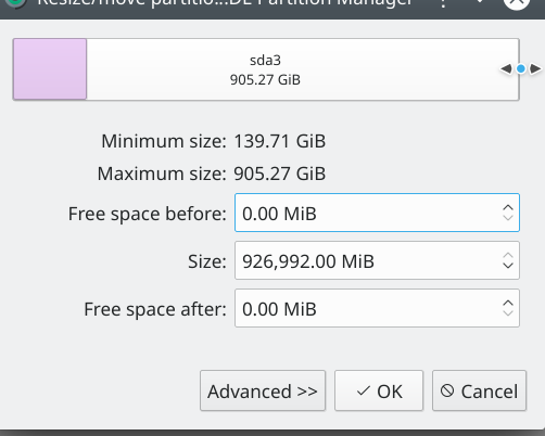

            'Folders" are not set in size per se. If you have your entire OS installed to one drive, using only one partition (which is the default setup), there is nothing to resize, as it is all 'shared', and you have the maximum space available to your home, downloads, etc, as well as your system files. Plamsa has an option for Trash size limits to keep it from growing so big it takes up too much of one's available free space.
            if you have multiple partitions, with a separate one for your home dir, the Trash folder is located inside that $HOME, so it is again sharing the same available space, with the maximum available, unless you shrink another partition in order to free up space to expand the $HOME.
            The Partition manager definitely has drag-to adjust.
