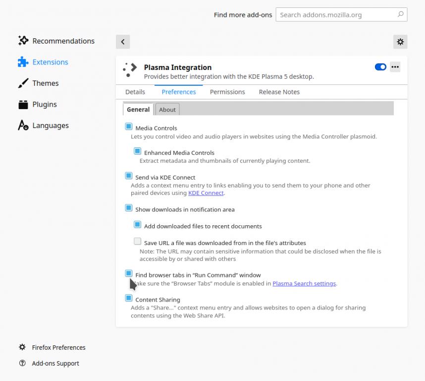

It is probably via the browser integration Firefox plugin that is prompted in the system tray when the browser is first run. This has been the norm for a few releases now, I believe, if not longer.
You can tweak settings in a couple of places:
via the plugin's settings:

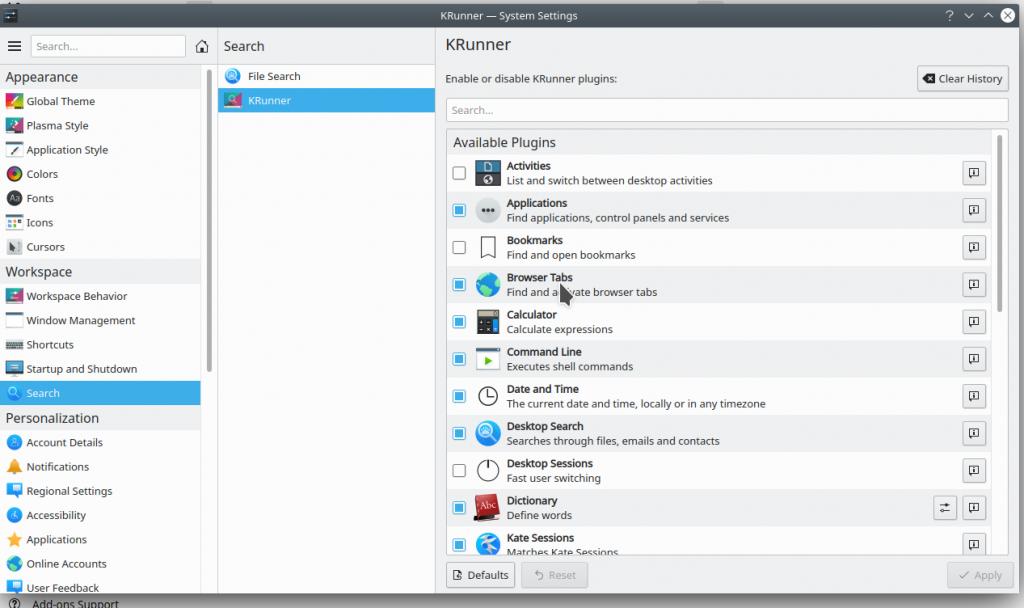

And/or via the Search options in System Settings - this is shared between Krunner and the Launcher.

1. I don't have the plasma-integration extension installed, and maybe that's for the better.
2. I didn't realize that Krunner was shared with the launcher; I disabled as you indicated.

For KDE 5:
Copy /usr/share/kservices5/plasma-runner-bookmarks.desktop
→ ~/.local/share/kservices5/plasma-runner-bookmarks.desktop
Replace a line X-KDE-PluginInfo-EnabledByDefault=false.
I did both 2 and 3, and this seems to have stopped it.We only have to look at ourselves to see how intelligent life might develop into something we wouldn't want to meet. -- Stephen Hawking

#3 just controls which runners are enabled by default, so it's redundant if you disable the runner in System Settings (or krunner settings) in step #2.
