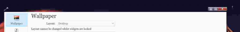

                Here is an issue I have from time to time as well. As you can see some of the decoration is missing but not all.
