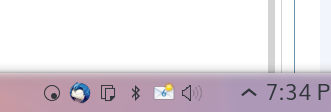

        firetray works fine here, but you have to reload plasmashell, or log out and back in for it to show up

                  yep your right the libappindicator3-1 was missing on a default installation so i installed it and now its showing properly (as per firetray) (except you still cant click left mouse to show/hide but cant have everything )

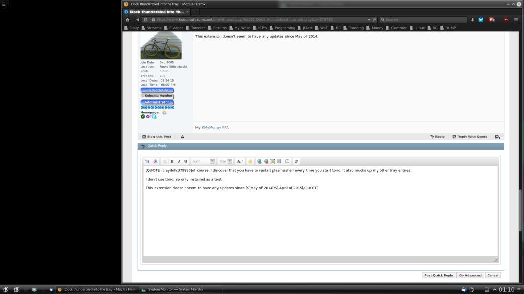

                      of course, I discover that you have to restart plasmashell every time you start tbird. It also mucks up my other tray entries.
                      I don't use tbird, so only installed as a test.
                      This extension doesn't seem to have any updates since May of 2014 April of 2015

                      Hmm i do have a "gap" in my tray now as well which does not seem to correspond to anything but im sure i can figure it given a little time.

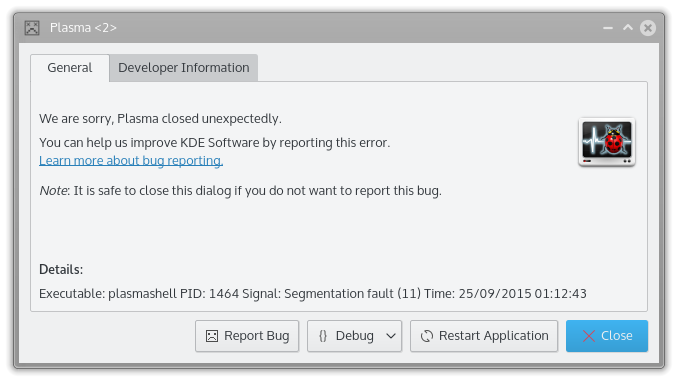

                      O dear just as im typing this i get yet another crash , gets tiring
                      I shall spend a little more time with this distro and see how i go, if it crashes much more though i shall prob drop it which is a pity as i really like this new KDE

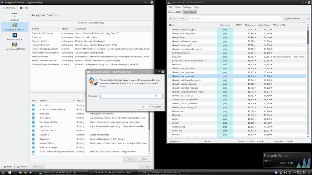

                        hmm, so i changed the session login and logout to "start with an empty session" and killed the kmail process. Kmail now does not start at boot but im still getting kwallet starting up at boot and popping up asking for a PW. do i stop that by killing kwalletd5 process and then it wont start each time?
                        many thx.
                          ok how do i stop this kwallet popping up at boot/login.

                          Why is it asking for my smpt wallet login when kmail is no longer running at boot/login ?
                          Iv shown the processes involved (i believe) and my startup background services settings but i cant see how to stop the wallet popup (center screen GUI) at logon?

                            Turn off kwallet in......System Settings, or if you use it to store your passwords, you can give it a blank password, and it will never bug you again
                            You do realize you are using and unfinished distro, right? Plus all the new and constantly updated KDE? Not to stop anyone from trying other distros, but I'll wager that you have the same Plasma, frameworks, and Applications versions in another distro, experiences will be similar.
                            The kwallet - pam integration looks to be missing have been broken, which is why you are getting the password popups. Fresh installs are supposed to hook the user login to the kwallet, so we would not get these prompts. Somehow, pam-kwallet is not being installed?
