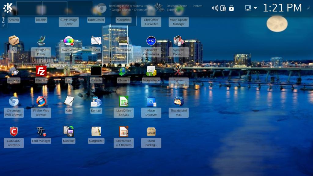

    I ran a virus scan in the wee hours of the morning and found 9 threats. When I woke up and sat down, I had Comodo quarantine them and rebooted. Done and done, right? Wrong. After I rebooted, the taskbar disappears and only reappears when I've got an application maximized. I had thought that part of the problem might be the "show desktop" icon on the taskbar, so I deleted it. No dice. Plus, when I can see it, it's covering up the top row of desktop icons (see screenshot). Clicking on "always visible" under taskbar settings does nothing. What am I missing? Thanks.

    The taskbar issue sounds like things I've seen that sorted themselves out after an unknown number of attempts to fix (or passing of time). Have you rebooted?
    Try setting it to "windows can go under", and then back again.
    If all else fails, you might have to delete the panel and make a new one.

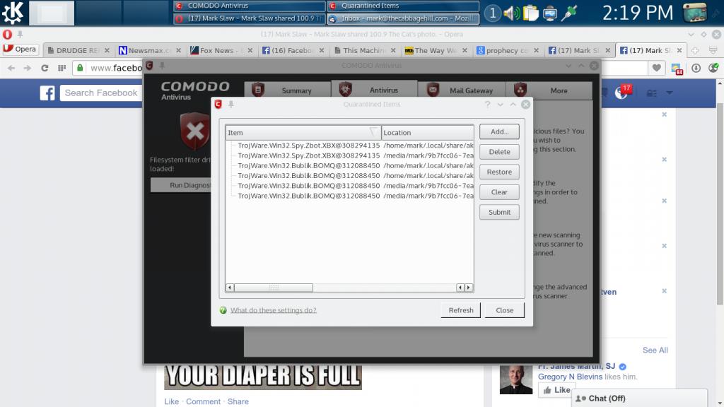

                          Sure. Here's the list of threats Comodo identified:

                          First time, Comodo found nine, this time six. None since then. Not really sure what that means except that I'm not running Windoze, in which case, there would be about 35 per day!
                            That's a Windows Trojan.
                            http://www.symantec.com/security_res...011016-3514-99
                            Do you have installed WINE on your Linux partition?
                            If not the exe file cannot be executed. Perhaps a Java applet on a website you visited saved it but couldn't execute it.

                              I find it interesting, if I am guessing some of the file paths correctly (~/.local/share/akonadi/), that it is finding some of these in the akonadi database, but not in an actual email. If akonadi indexed some malware code, it would also be present in the message itself and seen by the scanner, right?
