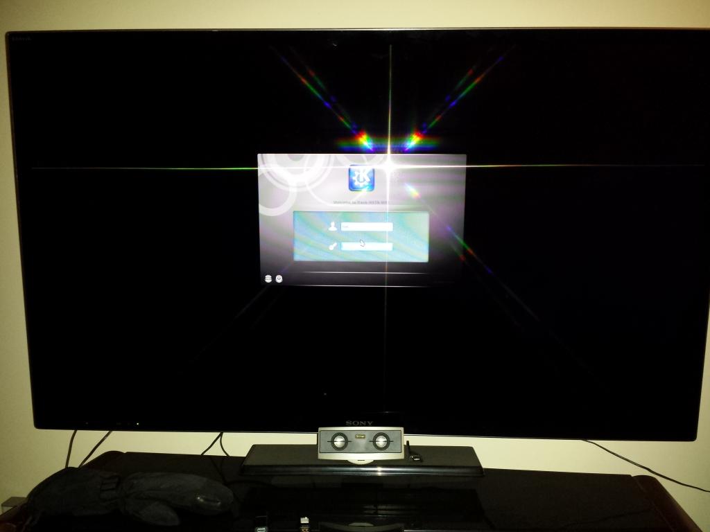

Kubuntu 14.10 Login Screen has tiny illegible fonts
    Ever since installing, this has been an issue.
    I haven't found anything in settings to address it.
    Display is through HDMI to my lcd tv.
    Once logged in all is well though I think I explicitly set the DPI.
    It would be nice to be able to read the login screen.
    Anyone know how to approach this?
    Thanks

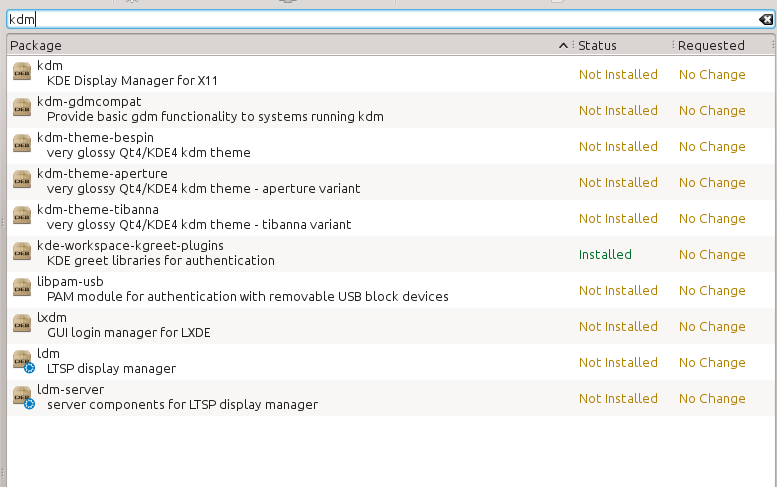

        May I suggest that you install kdm and set it as your default login manager? I think doing so will fix your issue. You can then switch back to LightDM if you desire, which also may result in it being fixed.
          sure
          none of the kdm results in the package manager show login manager
          sudo apt-get install kdm?
          or how to install?
          also, if you don't mind, how do I then switch to it?

            Yes. Run: sudo apt-get update && sudo apt-get install kdm kde-workspace-kgreet-plugins
            Because you have LightDM installed, you will be presented with the option to choose which Login manager you want as default.

                It is still very small but this time it is only taking up 1/8 of the screen so the whole screen is shrunk (see attach) albeit without the cool star effect the camera made

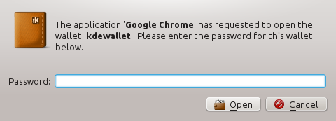

                and now to my dismay kwallet is popping up everytime i launch chrome (see attach)
                KDE neon LTS 5.12
                  You can turn off KWallet in System Settings.

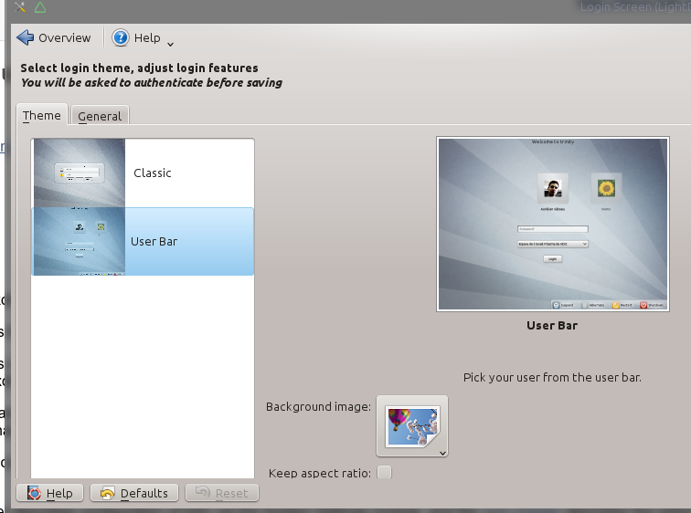

                        Regardless, when I try themes there are two issues:
                        When I install themes through "Get new themes" they don't appear in the list.
                        When I choose an existing theme, it doesn't look like the preview in settings.
                        but my fonts work!
                        KDE neon LTS 5.12
                          KDM has been unmaintained for a while now, I'm not surprised it's starting to exhibit problems like what you're seeing as you try to obtain new themes. The default display manager for KDE is now SDDM, which you'll see in 15.04.
