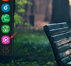

    For example, when SMPlayer is pinned on the Launcher (and closed) the icon theme is applied:

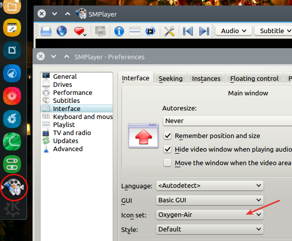

    But when I open the program, the icon changes like so:
    What can I do about it, how to fix this? Please, If you know how to solve this, explain to me (with steps if possible). Thanks ))

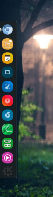

      I guess I wasn't correct, that is just a panel to which I pin program icons.
      The panel (or as I called it launcher) itself looks like this:

                - launching the applications - right clicking the task manager icon and picking the "Show Launcher When not Running" option "
                Now the SMPlayer icon is the SMPlayer logo when the player is running.
                The SMPlayer icons are themeable - SMPlayer > Prefrences > Interface: Icon set.
                By the SMPlayer forum: http://forum.smplayer.info/viewtopic.php?f=7&t=5259

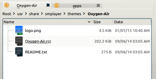

                Copying the Dalisha smplayer.png 64x64 icon to the /usr/share/smplayer/themes/Oxygen-Air/ (1) and rennaming it : logo.png.
                Changing the SMPlayer icon theme to Ogygen-Air. With the new logo:

                    Making the /usr/share/smplayer/themes/MyTheme folder and copying the MyTheme.rcc to there.
                    In the SMPlayer using the MyTheme Icon set - as the MyTheme only has the logo icon the other icons will be from the default set.
