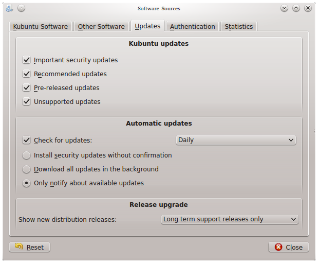

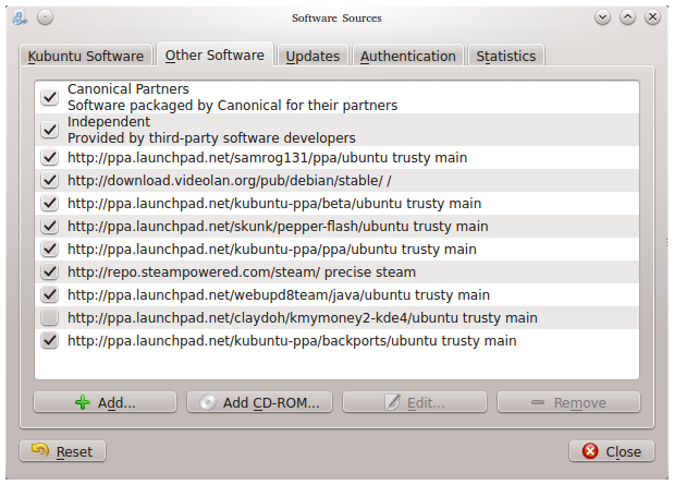

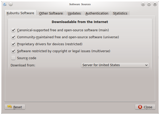

          What I am, and have been, using:
ID:	640764Click image for larger version
ID:	640765Click image for larger version

            The first thing to understand is that all the flavors share the same basic underlying operating system. So there's no need to install Ubuntu then add Kubuntu on top to be current -- you can simply install Kubuntu directly.
            The second thing to understand is that "LTS" is not an indicator of greater quality. It's simply Canonical's label for a support rhythm. A new *buntu release is issued every six months. In every other year, the April release is labeled "LTS," and it receives five years of support. The other interim releases receive only nine months of support. Unless you're managing computers in a corporate setting, in which frequent change can be a bad thing, there is no compelling reason for staying with an LTS for a full two years. You can generally keep yourself close to current by always upgrading to each next release every six months. It's actually quite easy. Just open a console window and type:
            sudo do-release-upgrade
            If you want to keep the KDE desktop even more current, then you might consider the additional Kubuntu PPAs, as listed in the page you linked to. Packages that land in Kubuntu Updates will eventually migrate to the standard repositories. If you don't want to wait for that to happen, then you can enable the Kubuntu Updates PPA, and receive KDE updates several days or weeks earlier. Kubuntu Backports will allow you to receive major KDE upgrades that would normally only appear during the next *buntu cycle. That is, if you don't want to wait the six months for the next *buntu release, you can receive many packages slated for that release several weeks or months earlier.
            My general behavior for managing is as follows:
            • Install the current version of Kubuntu
            • Enable the Ubuntu backports repository
            • Add the Kubuntu Updates and the Kubuntu Backports PPAs
            • Run apt-get update && apt-get dist-upgrade every morning
            • Run do-release-upgrade after each interim release goes public
            • Reinstall from scratch when a new LTS is released
            That last item -- reinstall each new LTS -- has nothing to do with the fact that it's an LTS. Again, LTS does not mean higher quality. I do a lot on my machines: install development stuff, play around with various configuration options, push the OS to its limits -- that eventually means I end up with a fair amount of cruft on my PC. I like to periodically pave and rebuild. I find that a two-year cadence for this is reasonable for me, so I align my rebuild cadence with Canonical's LTS cadence.
            From your description, it appears as if you do not want to set and forget: instead, you want a machine that has fresh bits installed soon after they're publicly released. If you follow the outline I listed above, this will be your result.
              I will not be preserving my home directory when I rebuild my T520. I've already saved important local files -- VM images, pretty much. Nothing else is local, but instead is stored in various clouds. Configuration files change over time; certain settings no longer exist, others arrive. The various hidden files in ~ and *rc etc. files scattered about can become as crufty as the rest of the system. I guess I like my newly-built machines to be sooooper clean
