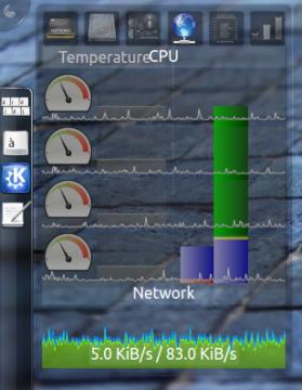

                      I've attached a screen shot of my top left corner to show what I mean and show off some layered plasmoids.
