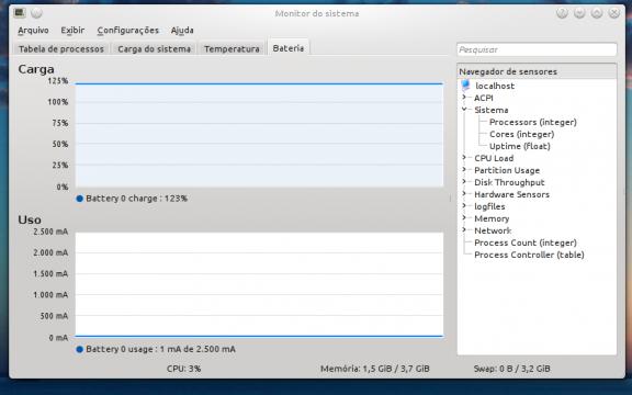

    Hello!
    I'm running Kubuntu 12.04.
    At system monitor battery charge displays 125%!
    How can it be fixed?
    What does the command "acpi -i" shows in console?
      It says:
      $ acpi -i
      Battery 0: Full, 100%
      Battery 0: design capacity 4500 mAh, last full capacity 3645 mAh = 81%
      It seems to be worning out, which is awful in many ways.
      But I usually use my laptop plugged in, I don't undestand why it is so worned out.
