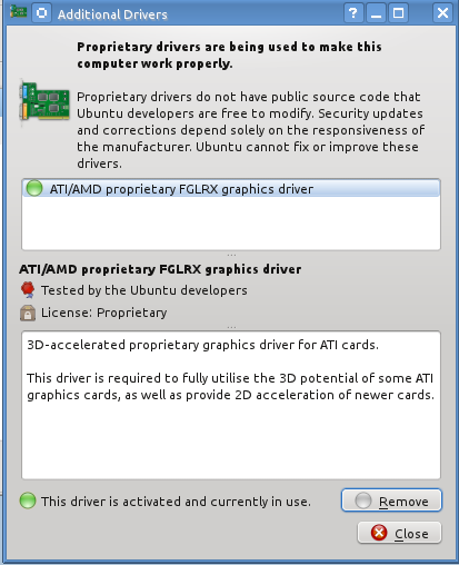

        Do you know if you are using the non-free video driver, or the proprietary one? Have you checked System > Additional Drivers to see if the proprietary driver is listed for use?
        Slava Ukraini! πŸ‡ΊπŸ‡¦
          Re: KDE is slow
          Thanks for the effort!

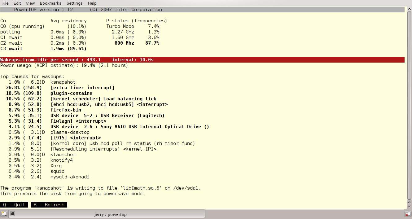

              When I get slowdowns I want to know what is hitting the IRQ, so I run
              sudo powertop
              and see what taking most of the Interrupts.

                  Re: KDE is slow
                  Originally posted by umpirsky
                  Wakeups-from-idle per second : 1075.8 interval: 10.0s
                  Wow! With only a konsole open, running powertop, my total wakeups are around 115 -120 p/s.
                  Top causes for wakeups:
                  45.1% (1000.4) [kernel module] hrtimer_start (cx88_ir_work)
                  25.4% (562.5)D chrome
                  15.5% (344.1) [Rescheduling interrupts] <kernel IPI>
                  0.0% ( 0.3) Xorg
                  Xorg isn't doing much, but something is aggravating your hrtimer, causing a lot of IRQ rescheduling.
                  Chrome doesn't appear to be playing nice, either. It must be doing a lot of background fetching.
                  Run powertop on an empty desktop, except for the konsole.
