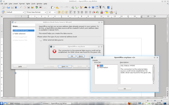

        Re: kaddressbook mailmerge
        A bit more info...
        Kubuntu 10.04 (Lucid Lynx)
        KDE 4.4.2
        OpenOffice.org 3.2.0
        1) Open "Address Book Data Source Wizard"
        2) Only "Other external data source" button is shown
        3) Click on "Next" (with or without above button selected) and error message for OpenOffice.org Base appears: "The connection to the external data source could not be established. No SDBC driver was found for the given URL."
        4) Click on "More" and Error is expanded to "SQL Status: HY000 - The connection to the external data source could not be established. No SDBC driver was found for the given URL."
        Running Ubuntu 10.04 (Gnome) with OOo 3.2.0 on a different PC, the data source wizard works as expected, showing the Evolution address book and allowing other sources, such as "Spreadsheet" to be registered.
        Has anyone else seen this bug with OOo/KDE?
