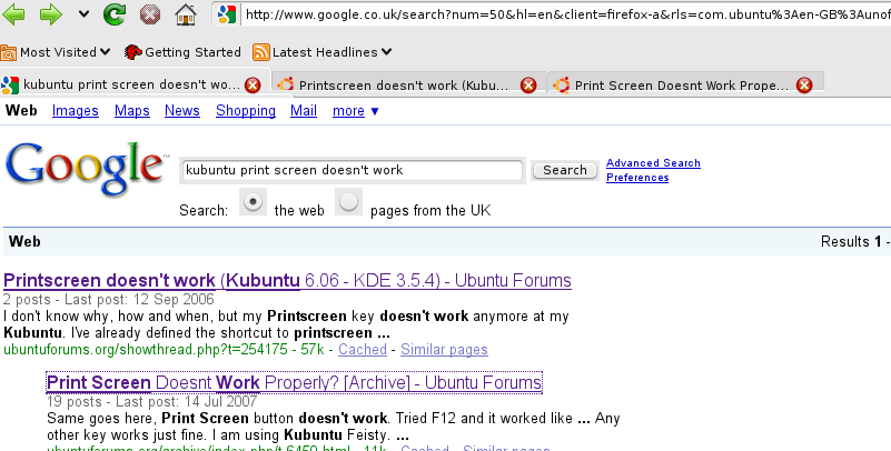

    I've been messing about with Kubuntu for a week now (having been running an LFS box for years and been using UNIX for longer but this is my first foray into running a linux desktop) and I just doesn't seem to be slick. I'm sure I must have missed something but I don't know what.
    First up Firefox, there's something wrong about how it's being rendered. The attached screen shot shows you what I mean (guess what I couldn't get to work when I took it!). The tabs aren't rendered properly and radio buttons seem to have a grey boarder. I've done some digging and found comments about downloading various qtk packages but that doesn't seem to have helped. There was also an Oxygen theme (I think) for firefox that I downloaded but that didn't make any difference. (All of this is aside from the font problem I started with here the whole thing just looked horrible and I had to go and find a different font to install and use).

      It is possible - if you are using the KDE 4x desktop, that the problem of Firefox rendering incorrectly can be cured if you install
      sudo apt-get install gtk-qt-engine=1:0.8-1ubuntu2
      That worked for me.

          OK, the package is gtk2-engines-qtcurve
          so, do:
          sudo apt-get install gtk2-engines-qtcurve
          then open KMenu->System Settings->Appearance->GTK Styles and Fonts and set "Use another style" (under category GTK Styles) to QtCurve. Save it and restart Firefox. That should take care of the ugliness in firefox. for the life of me, I don't know why this isn't the default behavior...

            Thanks for that. I checked Synaptic and I already had that package installed. However I've now been through the system settings and changed them and it appears to have made a difference. It's better but I still wouldn't say polished, but we're getting there. Evolution still doesn't look great but I think that's just the way it looks. Menu bar and stuff are fine, it's just the stuff IN the windows that looks pants.

              Oh yeah, for firefox, I would download a new theme for it, the default is ugly. There are a variety out there, I use one that makes it look like IE7...there is also a KDE specific theme that is nice, makes FF look more like the windows version of FF.
