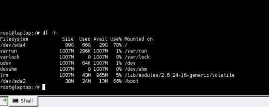

        root@laptop:/# df -h
        Filesystem Size Used Avail Use% Mounted on
        /dev/sda4 99G 66G 29G 70% /
        varrun 1007M 296K 1007M 1% /var/run
        varlock 1007M 0 1007M 0% /var/lock
        udev 1007M 64K 1007M 1% /dev
        devshm 1007M 0 1007M 0% /dev/shm
        lrm 1007M 43M 965M 5% /lib/modules/2.6.24-16-generic/volatile
        /dev/sda2 38M 24M 13M 66% /boot

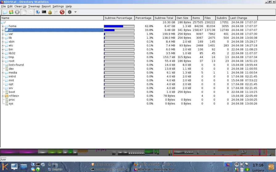

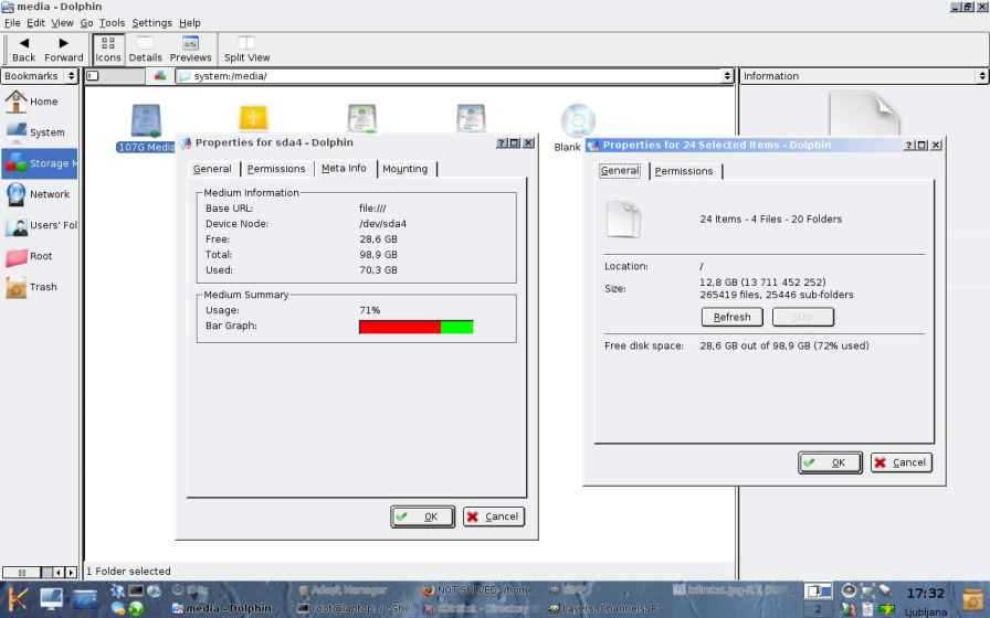

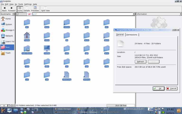

        After deleting .strigi/ there is still 66GB of data which is still not normal
        I attached a screenshot. You will see that the used space of all files on / is about 10GB
        while df -h shows 66GB used
        Whats up with that ?
