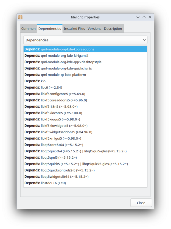

    That isn't the only dependency however. This is what apt shows as the dependencies when I review the application in Synaptic Package Manager:
    So you should check to see if you have these installed.

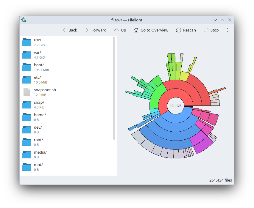

    Filelight running on my laptop:
