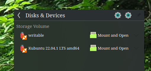

              That depends on how the iso was written to the USB drive. The two I've found to hand were set up with a writable partition, and the disks and devices pop-up tells me:
              If the iso has been written by a raw copy, as if by dd, I don't know what the disk and devices pop-up says. If it doesn't say anything useful, you should be able to mount the raw device then look in the dists directory. If KDE doesn't present a mount option, perhaps something like sudo mkdir /mnt/usb; sudo mount /dev/sdc /mnt/usb would work.
