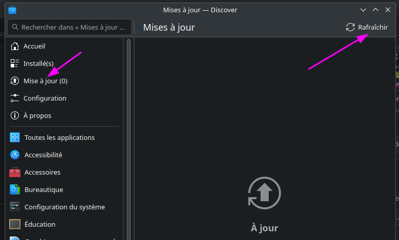

                The screen copy in ordrer to illustrate this post :
