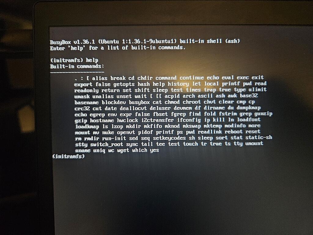

    Since upgrading 24.04 -> 24.10, every boot drops into initramfs, and nothunig seems to work in it anyway. reboot commonad does nothing forcing a hard reboot (push/hold power button).
    Then it goes to grub on boot.
    This is consistent behaviour -- every boot forced or not drops into initramfs, forcing a hard reboot, then I get grub and can go on as normal.
    What's it doing and why? And how do I stop it?
    Click image for larger version  Name:	20241014_203529.jpg Views:	34 Size:	115.0 KB ID:	683565

    I suspect a grub problem. I imagine grub is running something because it thinks it's the only option, and it fails to load a kernel, but sets the record fail flag so on the next boot it gives the menu.
    So, I suggest rerunning update-grub, perhaps after editing /etc/default/grub to remove the words "quiet splash" where they appear, and setting GRUB_TIMEOUT=-1.
    That's in a konsole:
    sudo update-grub
      Solved. Looks like I needed to fsck my boot drive
      Double check filesystem type and make sure I had the correct device name
      blkid
      which gave
      /dev/nvme1n1p2: UUID="4ab857b4-36ee-4782-8cb6-ce87346be2c1" BLOCK_SIZE="4096" TYPE="ext4" PARTUUID="47b78b23-bc4f-4d91-886d-de2b039aba9f"
      Then, as it's ext4
      fsck /dev/nvme1n1p2 -y
      ​And
      reboot -f
      to reboot -- I had been missing the -f flag before so it didn't do anything
