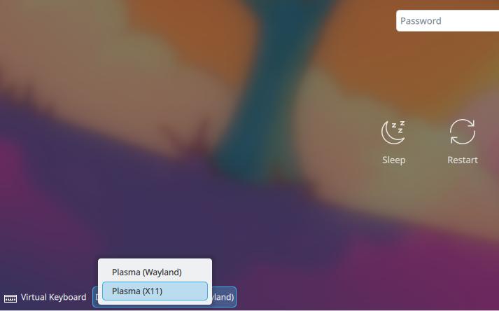

Originally posted by johngx View Postdriver: N/AThis is the real issue: you aren't loading the i915 driver for some reason, which would explain the resolution as well as using software renderingOriginally posted by johngx View Postrenderer: llvmpipe
so.... try logging in with x11 instead of Wayland at your login screen, though I highly doubt this will fix anything, at least to eliminate the simple stuff.

About what??Originally posted by johngx View Postcomplains
You select the option at your login screen.Originally posted by johngx View PostI don't know how to switch between Wayland and x11
