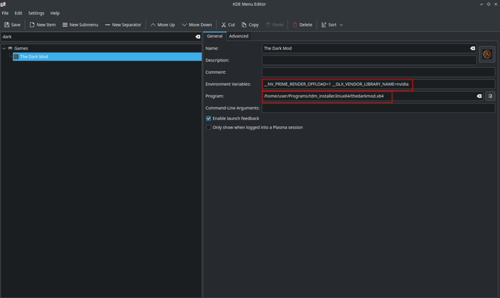

    However some other game https://www.thedarkmod.com/main/ does not want to automatically use Nvidia when i run it. First I had to create a desktop entry for the binary and define the working directory and this is just to easily run the game:
    Next I had to use the following line as an environment variable to use the Nvidia GPU:
    __NV_PRIME_RENDER_OFFLOAD=1 __GLX_VENDOR_LIBRARY_NAME=nvidia
    Now i have 2 questions
    1. What mechanism does Kubuntu use to detect that i am running a game and start using the Nvidia ? How does Kubuntu knows ?
    2. is there a way to let Kubuntu automatically run games using Nvidia without having to add those env variables mentioned above ?
