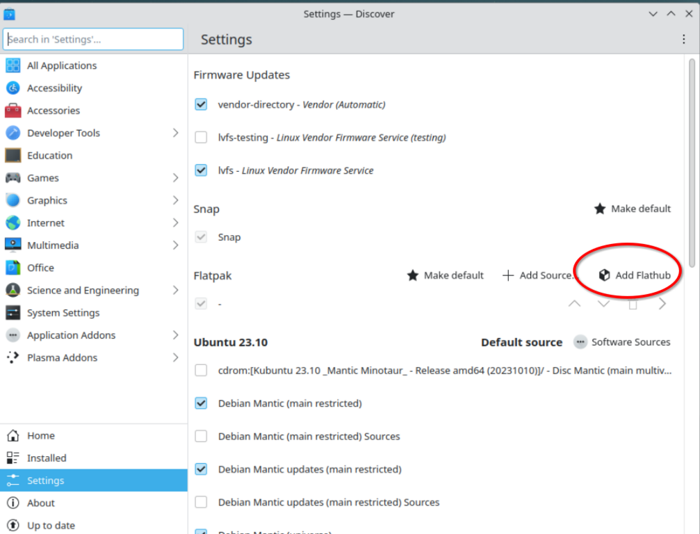

    3. to enable the Flathub repository​ for Flatpaks
      EITHER in Konsole enter
      flatpak remote-add --if-not-exists flathub https://flathub.org/repo/flathub.flatpakrepo
      OR in the -> Application Launcher -> System ->​ Discover software center
      -> in the left part go to Settings -> click the button at the right side [Add Flathub]
      (both will enable the Flathub repository for Flatpaks, which is currently the largest one and is supported by e.g. KDE and GNOME - you can enable other Flatpak repositories like e.g. the one from Fedora or from individual developers later on if you wish to do so)

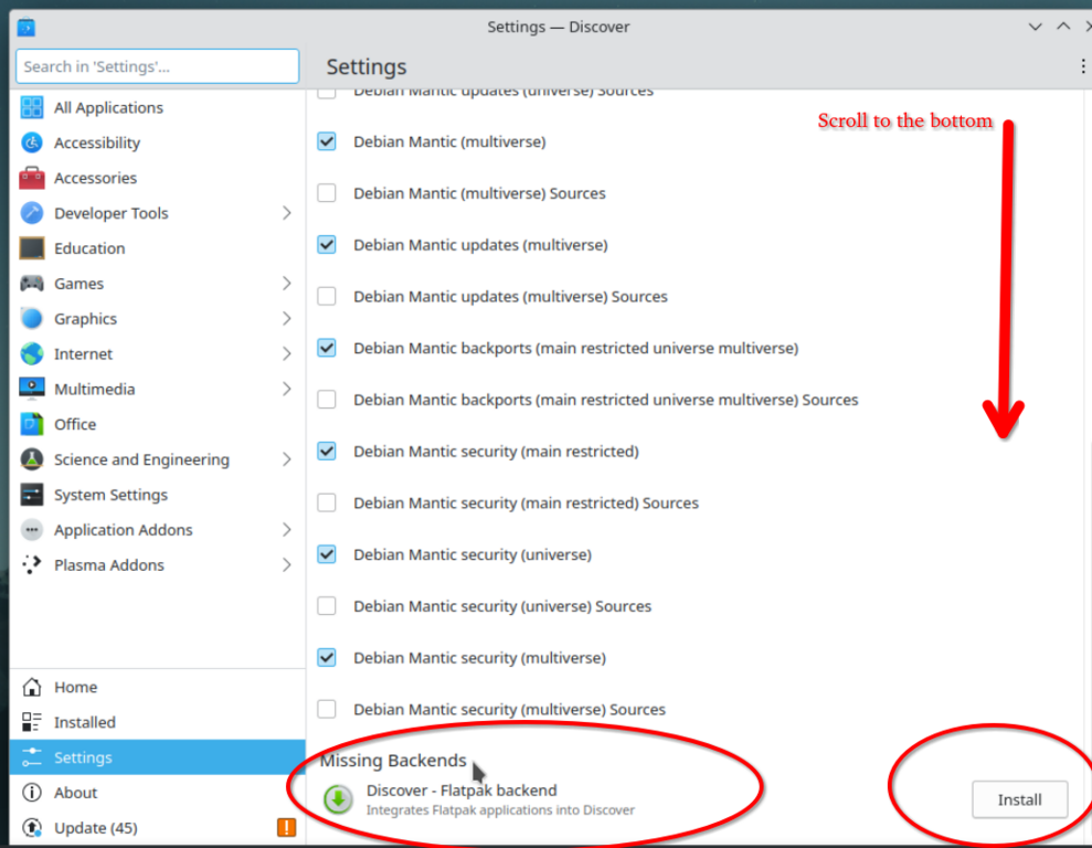

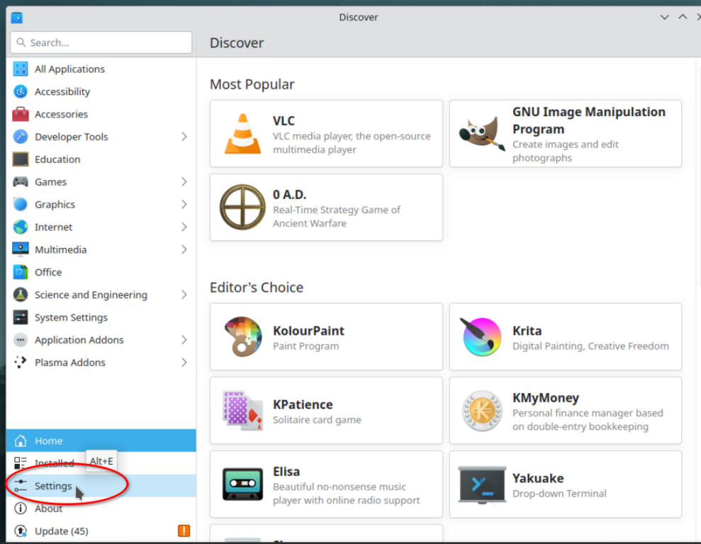

    The easier method, for some folks:
    Click image for larger version  Name:	Screenshot_20231118_135058.png Views:	4 Size:	257.6 KB ID:	675360 Click image for larger version  Name:	Screenshot_20231118_135146-1.png Views:	4 Size:	267.2 KB ID:	675361
    Reboot, as prompted
    Click image for larger version  Name:	Screenshot_20231118_135637-1.png Views:	4 Size:	214.0 KB ID:	675362 Click image for larger version  Name:	Screenshot_20231118_135715-1.png Views:	4 Size:	227.0 KB ID:	675363
    This may or may not be available in 22.04, I don't have a 'clean' setup to check atm. I *thought* it works the same, but cannot confirm.
      Thank you very much for your addition!
        I just tested it in a "vanilla" Kubuntu 22.04 LTS - unfortunately the "Install Missing Backends" option is not availabe there in Discover's settings.
        I also tested it in a "vanilla" Kubuntu 23.04 - there it does work!
        So this "easier method" only works in Kubuntu 23.x. - I also linked your post from the Kubuntu 23.04 tutorial.
