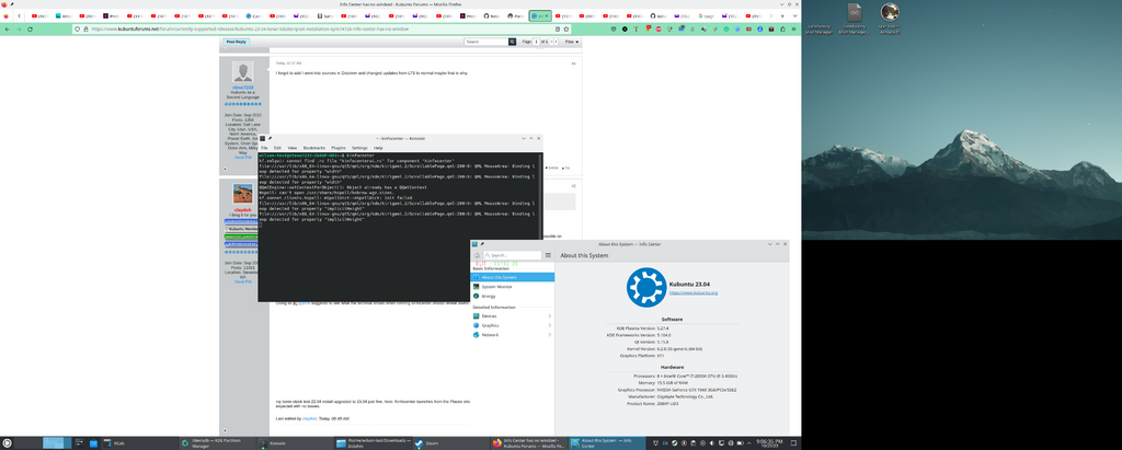

    Running kinfocenter in a konsole might give a clue, buried in the trash messages that can be ignored; I get 8 lines of these.

          Doing as jlittle suggests to see what the terminal shows when running kinfocenter should reveal useful info.

            This time it worked but I see errors. Kubuntu has let me upgrade skipping versions in the past so this bug has been hiding for several years. I wish I knew it was a bad idea sooner.
