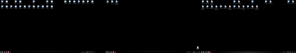

    Here are some screenshots showing the issue.
    the first one I upload is taken before leaving for the day/work

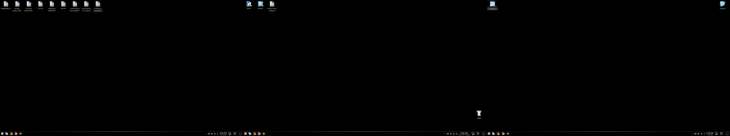

    the second one is returning from work

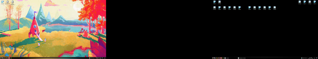

    the 3rd one is just after I woke up..Monday morning I think it was...

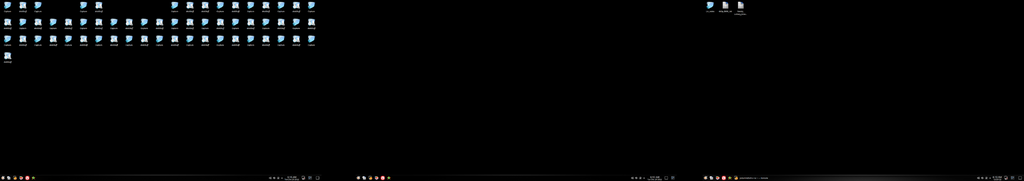

    the 4th is a couple days latter with no reboots/lock screens - middle monitor, my primary, has no taskbar, icons, the only thing the way I left it is the background color - I do not use wallpaper. So, like usual I rebooted, then fixed everything.

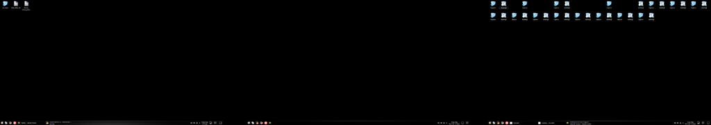

    The 2nd last one is today arriving home from work.
    The last one is this morning: 2.5 days no reboot, no lock screen, monitors go black after some time (monitor sleep I guess - it is not the OS doing this) and the monitor with all the capture and desktsuff folders?There is only two folders - the rest are duplicates.
