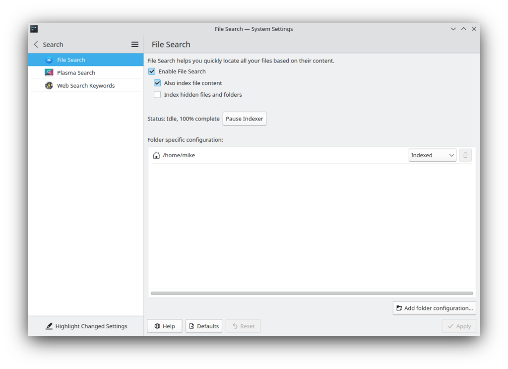

                      OK, Plasma's Search. I set the options as shown on the screenshot
                      I open Dolphin and search for this string: Probably that person's job
                      I get two odt files, say F1 and F2. F1 is a bingo -- it contains exactly that string, and it's the file I am looking for.
                      However, I open F2 and do a Find on that string: Probably that person's job.
                      It is not found in F2. Individual words are found in F2, like "Probably" and "job."
                      Again, in Dolphin's search, I enter this string: Probably that person's job is either a company worker or a teacher
                      This time, only file F1 comes up in the search; and, in fact, F1 does contain that string, verbatim.
                      F1 is the file I was originally trying to find, and I found it, using Dolphin, by entering some of its contents, namely: Probably that person's job
                      But my question is this: Why did File F2 also come up in the search for that string, when, in fact, the Find (in LibreOffice.Writer) did not find that string in File F2.
                      What's going on, do you think?

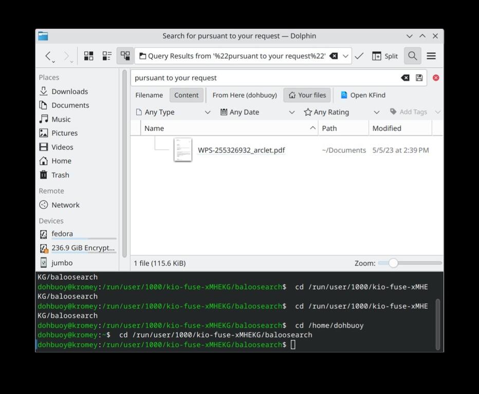

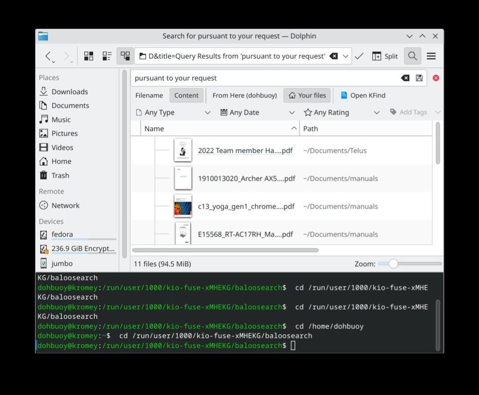

                        Partial matches can be useful. most search tools will include these, and often is the default.
                        Try using quotes around the exact phrase. This is the usual way to keep partial phrase and single word matches out of results on the web, or most any search tool - even our forum's search.
                        Here is an example from me searching the phrase "pursuant to your request", both with and without quotes:
                        Click image for larger version  Name:	Screenshot_20240612_005800.jpg Views:	0 Size:	71.1 KB ID:	680518 Click image for larger version  Name:	Screenshot_20240612_005832.jpg Views:	0 Size:	63.1 KB ID:	680519
                        On the second, I did add quotes, honest, though they disappeared after the file was found. But it found the only file here that has that exact phrase in it.
                          Your results are dramatic. 😲
                          Interesting because I actually did try using double quotes before posting last night, and your take on it confirms my thinking, too.
