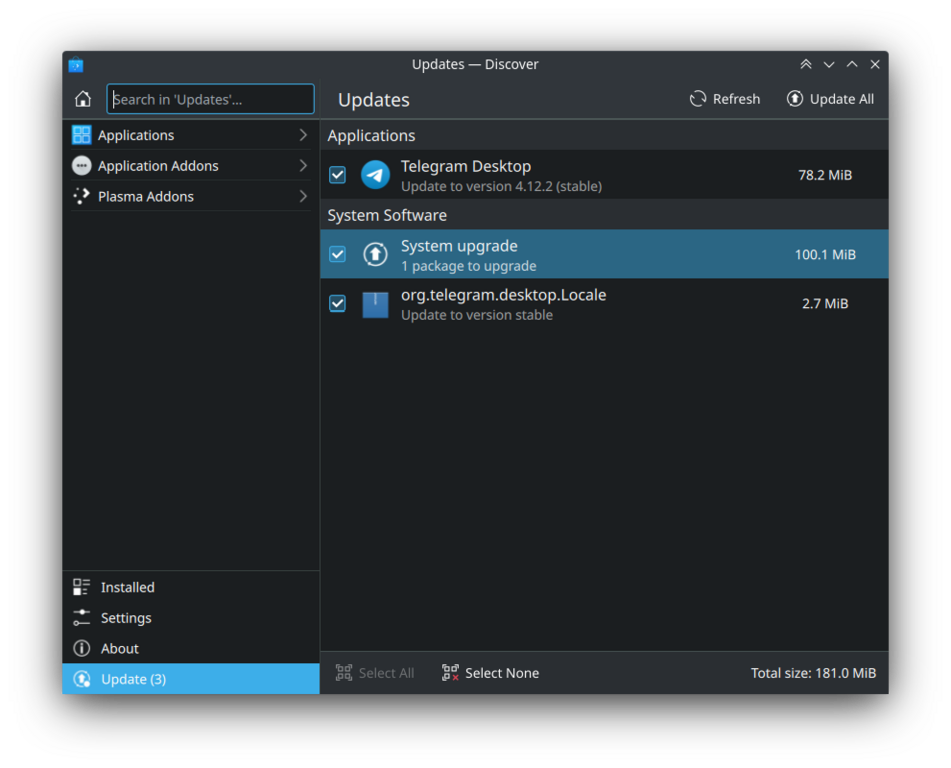

    Click image for larger version  Name:	image.png Views:	0 Size:	120.5 KB ID:	676087​
    Say I had google-chrome-stable, libc-bin, and​ firefox​ all needing updates. Under System upgrade, it would say "3 packages to upgrade." Alone, this is innocuous, but the problem is that updating these packages through Discover does not prompt me for my password. That is, somehow Discover is bypassing sudo (or has been opened with sudo already active), whereas before it would always prompt me, and nala/apt still requires me to do so. Finally, after updating this "System upgrade" (which sometimes is literally just Firefox), I am prompted to restart my system, and I am unable to download any more updates until then. That is, if I have flatpaks that I now need to update, but I installed that "System upgrade" update, I am not shown those updates until I've restarted.

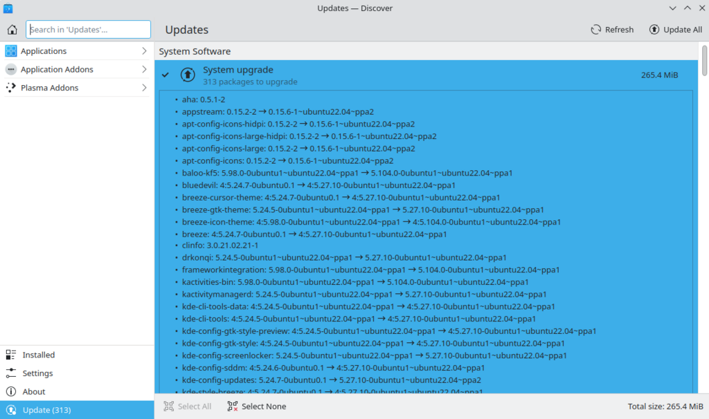

      You have the offline-updates option enabled. You can click on that one update entry and see what it consists of:
      Click image for larger version  Name:	Screenshot_20240110_102301.png Views:	0 Size:	294.5 KB ID:	676090

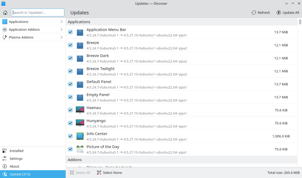

      Look in System Settings at the bottom and un-check the Offline Updates option, and restart Discover.
      Click image for larger version  Name:	Screenshot_20240110_102232.png Views:	0 Size:	167.4 KB ID:	676091
      You don't need a sudo password prompt for something that is being run as 'root' user during bootup., so that is not a bug.
