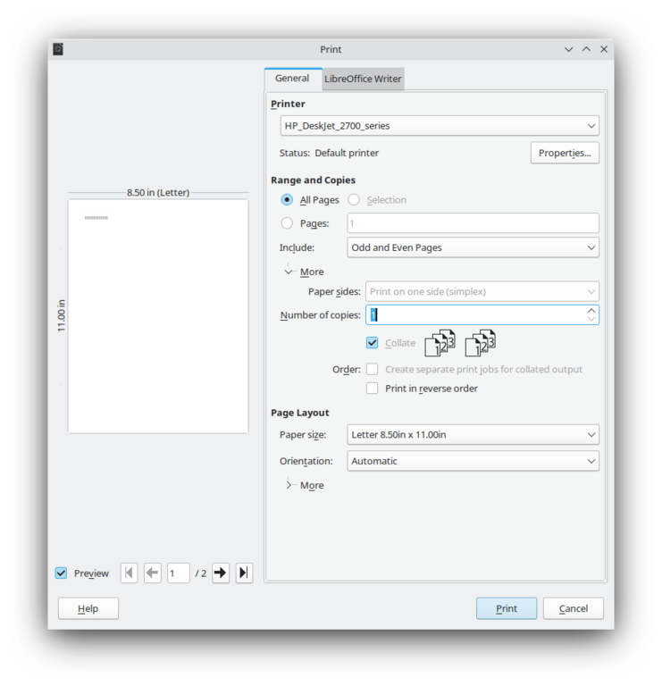

      If I am in LO Writer, with a 2-page document open, and then press File > Print, I get this menu:
      Click image for larger version  Name:	Print_menu_LO_Writer.png Views:	0 Size:	93.7 KB ID:	675199
      Notice that option: Print in reverse order. It is unchecked. And it prints in this order: page 2 then page 1 = the reverse order!!
      Now if I check that box (next to Print in reverse order), it prints in the "right" order: page 1 then page 2.
      Is that what you mean? If so, what a strange way for LO Writer to present things. IOW, to get the "right" order (page 1 then page 2), you use a double negative: Print [the reverse order] in reverse order? Btw, this 'double negative' DID work. Also, btw, I have to check that box each time I print a document to make the printing go in the 'right' order. I am unable to locate a global setting like that.

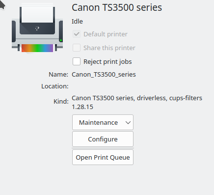

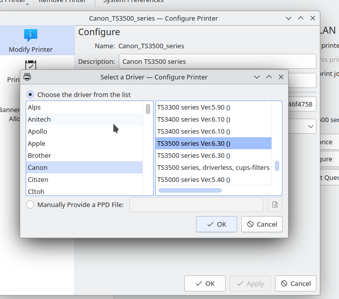

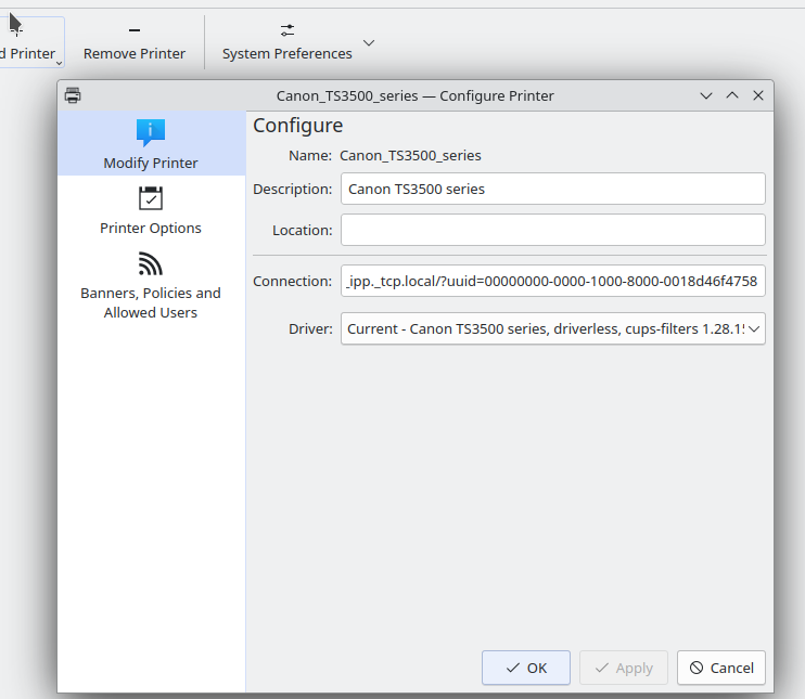

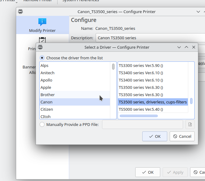

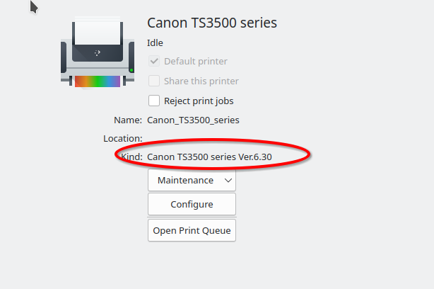

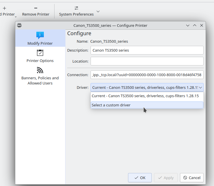

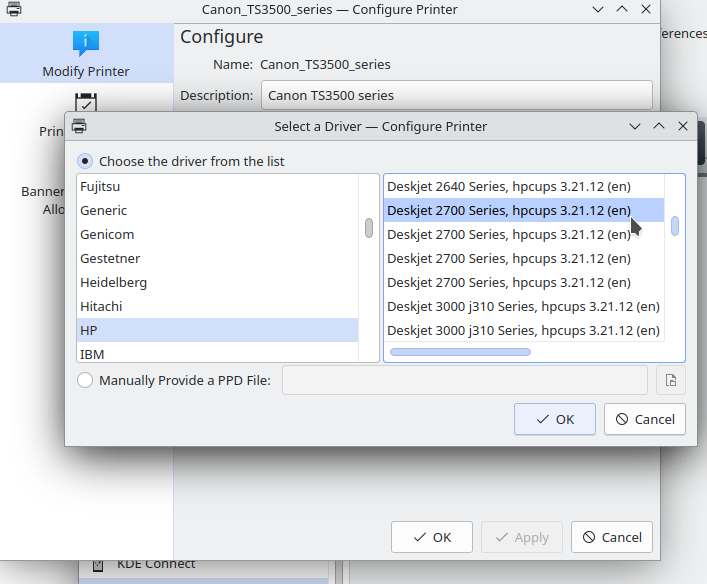

                I will use my wifi connected and autodetected bargain-bin canon as an example below, though switching to Canon drivers offers zero extra settings:
                Click image for larger version  Name:	Screenshot_20231111_102400.png Views:	0 Size:	31.0 KB ID:	675208 Click image for larger version  Name:	Screenshot_20231111_102447.png Views:	0 Size:	58.6 KB ID:	675209 Click image for larger version  Name:	Screenshot_20231111_102538.png Views:	0 Size:	69.1 KB ID:	675210 Click image for larger version  Name:	Screenshot_20231111_102815.png Views:	0 Size:	91.3 KB ID:	675211 Click image for larger version  Name:	Screenshot_20231111_104302.png Views:	0 Size:	37.5 KB ID:	675214
                Then see if you are offered more options.
                To go back, one can either switch back to the Driverless selection (it may be buried somewhere in the very long list), or delete the printer and re-add it

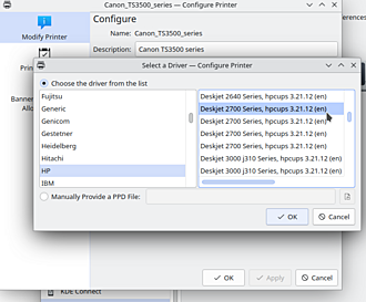

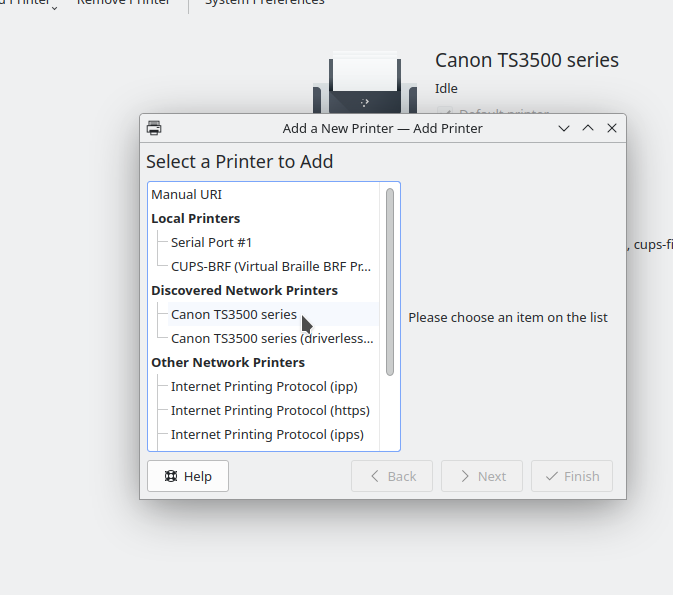

                if you are connected over wifi, and feeling adventurous, you can try adding a new printer, let it discover things, and you may be offered multiple choices for the same device, like I am:
                Click image for larger version  Name:	Screenshot_20231111_103821.png Views:	0 Size:	66.8 KB ID:	675213
                Select the one not marked as driverless, and go through the same process to select the HP driver. Give it a unique name so you can tell which one is the original.
                Then you can try both and see what you have , and delete the printer you don't want to use. This is exactly what I did on my previous 20 dollar printer
                If connected via USB, this is where you might consider removing ipp-usb, and then trying to selecting the appropriate HP driver'
                As you can see, none of this will involve HPLIP graphical stuff, just your normal settings options. The drivers themselves are normally installed by default. The package will be called printer-driver-hpcups. It does list your model, with the driver shown three four times of course. (My canon has the same driver listed twice, fwiw)
