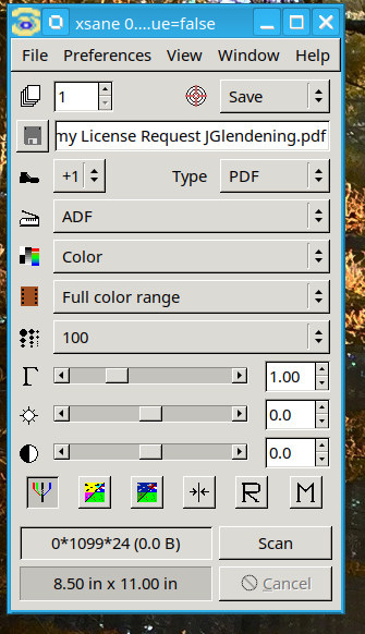

    But, it's not working. Instead of scanning the 8.5x11" page, it scans only the top couple inches!
      I found the xsane was the only app that would let me scan with my HP DJ 3755. It takes a little configuring. I keep these notes, but the notes are specific to my HP Printer/Scanner:
      Select Graphics/Xsane from Menu
      In Device Selection box: Hewlett-Pac deskjet_3700-ser all-in-one, and OK button
      Enter the filename to Save (typically in ~/Downloads) with PDF Type
      Push the document into the scanner (from the front) and hit the Scan button on the xsane app​
      Once you've selected the scanner type, you can set the printer paper size, etc.

        And then xsane looks like this:

          Boy, it's really screwed up. The paper size is selected correctly, and even the preview is right. But the scan is truncated as I said, down to a couple inches at the top. Something is fundamentally goofed up! Maybe the machine itself is broken. It is somewhat old.
            I tried your exact steps, jglen. I got that same xsane window, settings and file name all set correctly, I hit Scan and I got a scan of only the top couple inches. When I try to get a preview (Window > Preview), it looks OK, but no scan! Thanks.
              O.K., well sorry about your results. It would seem to be a possible hardware condition.
