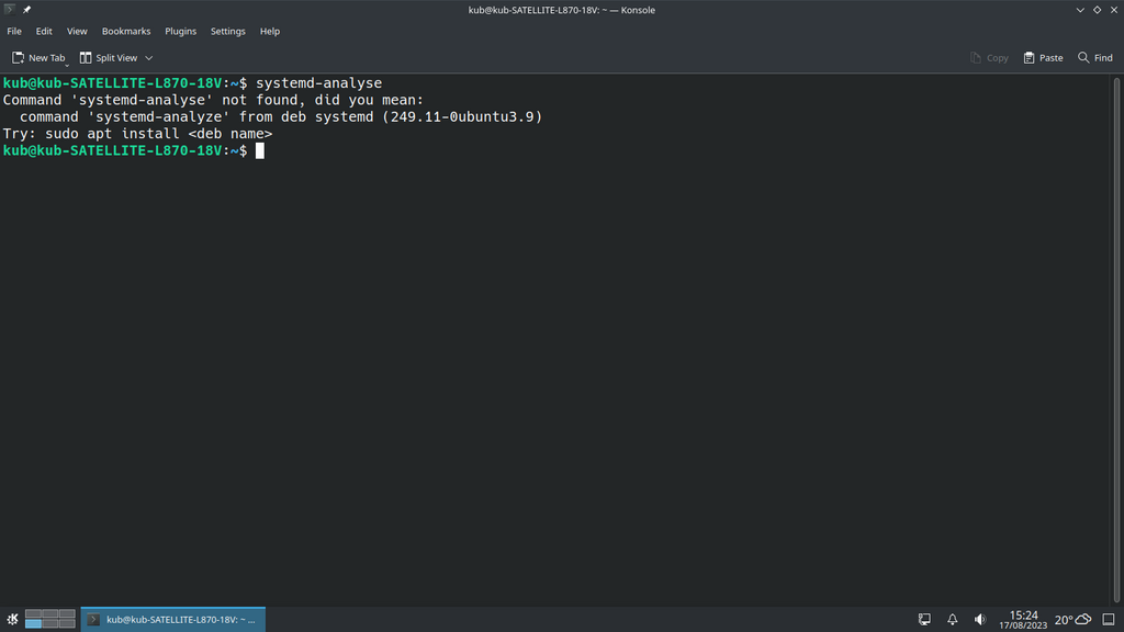

        Good afternoon,
        claydoh: when I try to run systend-analyse, the system responds as shown below.
        What now ?
          Originally posted by stuarte View Post
          Good afternoon,
          What now ?
          it is easier to copy and paste the text, highlight/select it, and use the "#" button in the text editor, for this sort of action. It can be hard or awkward to view the text in an image, especially on mobile.
          But, you need to use a 'z' instead of an 's' in systemd-analyze, as the message suggests.
