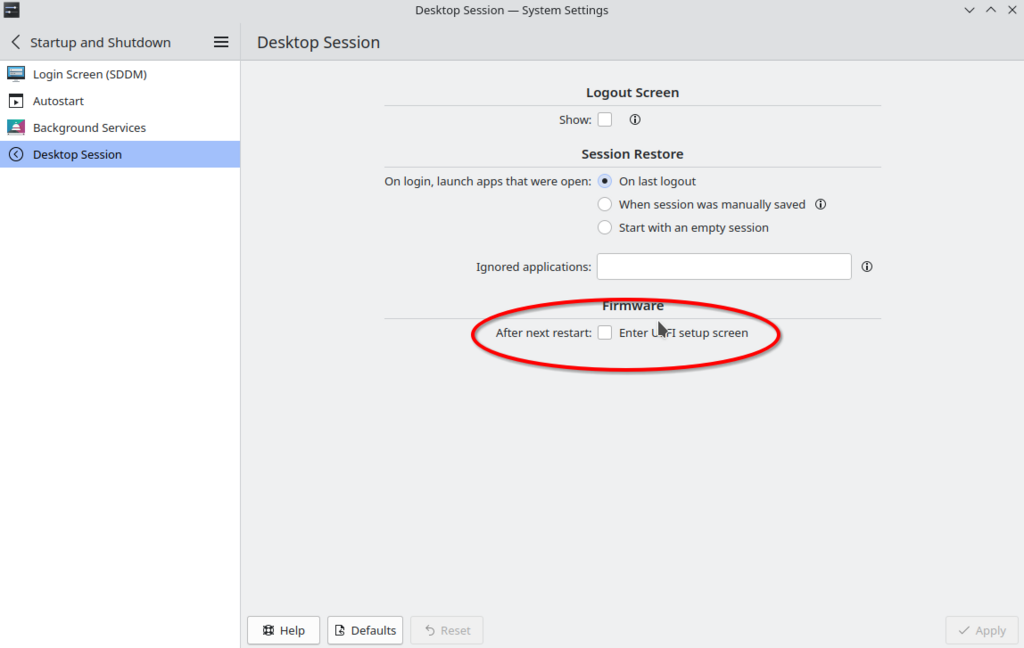

        b) Any, but not directly - BUT in System Settings, you can usually set this for a one-time boot. This should work from a live session, as it is just using a command line tool to tell the UEFI system to go to the setup menus (your BIOS).

        Or the command systemctl reboot --firmware​
        from the command line, which will work on non-KDE live sessions (I have no clue where this option is located on different desktops, I am sure that it does in many)

            Click the image to open a larger zoomable version.
            On Chrome OS you can zoom using the same Ctrl+ and - keys or via its three-dot menu on the top right of the browser
            The setting is located at
            System Settings>>Startup and Shutdown>>Desktop Session
            You can do this from a live Kubuntu USB, either from system settings or konsole using the command I gave

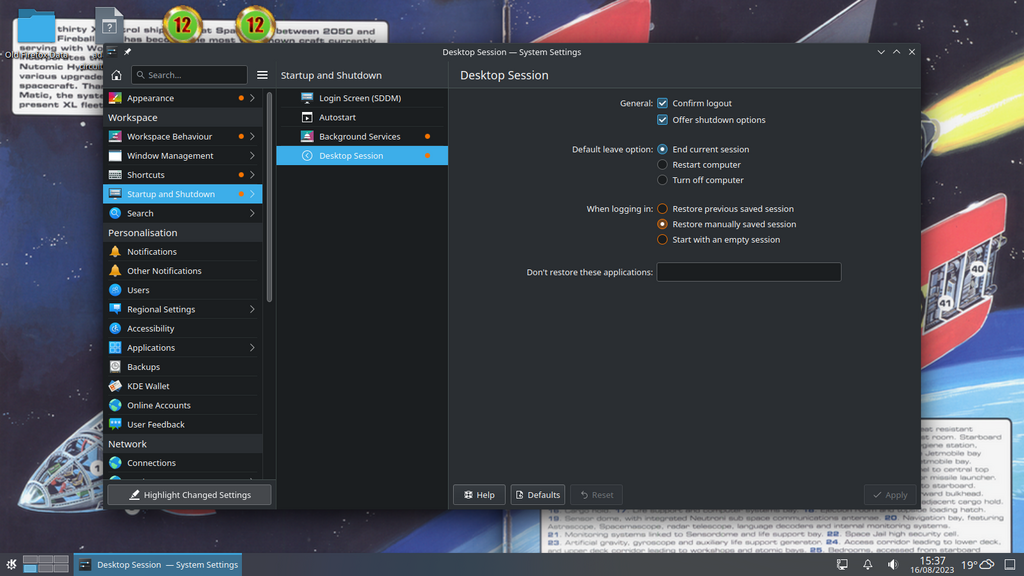

                        claydoh: wrt the image you provided in post #4, the Chromebook did not enlarge it but the laptop does, quite a bit. Also, the contents of the "Desktop Session" shown in that image differ markedly from those shown on my laptop. Please see attached file, desktop_session.png.
                          Are you actually using Kubuntu 22.04? My image was taken from a mostly stock setup
                          In any case, the command I gave does the same thing.

                              As you can see from my image in post #12, my Desktop Session dialog does not(!) have that control. How did you set that up ?
                              That is part of a default Plasma. You should have it. I don't know why you don't see it. I see it on every KDE install no matter which distro it happens to be.
                              What custom theming or colors are you using here? Maybe yours has a bug or something that is hiding it? This seems unlikely to be the cause, though.
