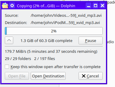

      Now, when I copy, I get a normal window. There is a progress bar which shows a percentage, which is helpful.
      The odd thing is, sometimes it shows a transfer speed but a lot of times, it shows stalled while at the same time, the percentage goes up.
      Well, in the screen shot, it show 179.7 MB/s for now.

        The 'classic' window vs the 'bubble' are showing the same exact data from the same sources, just with a different appearance.
        You can configure the bubble to always show
