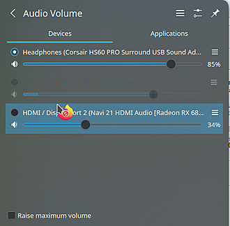

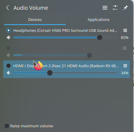

    Also look at your audio tray applet and make sure that the application is actually set to play through a specific sound device, if you have more than one. Drag-n-drop can fix that if it has moved to something you don't usually use.
    I do this often enough, and accidentally send something to my HDMI-out, which goes nowhere
    Click image for larger version  Name:	Screenshot_20221010_161932.png Views:	0 Size:	109.5 KB ID:	665834
