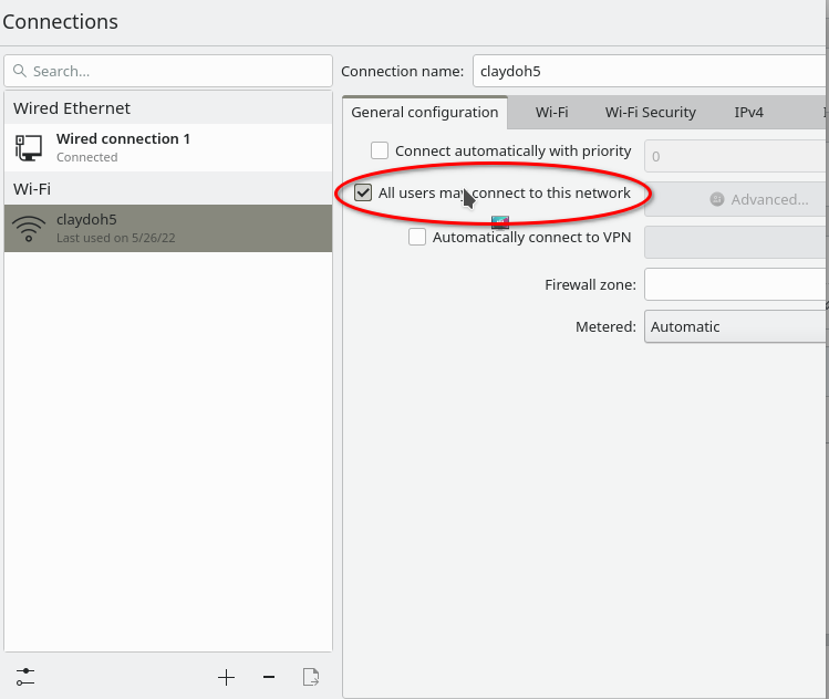

          IF you are using WiFi to connect to your network, a quick thing that may fix this all by itself, is to set that connection to be available to all users , which makes it available during boot, as opposed to after login.
          This might or might not work, depending on how long it takes to connect, and you might still need the _netdev option in the fstab.
          If you are connection via Ethernet cable, double check that this setting is enable there, though it normally should be.
          Click image for larger version  Name:	image_9464.png Views:	3 Size:	51.0 KB ID:	663769

            Thanks for all of your info. After some trials. I found out that if I connect my laptop to the network using ethernet cable. The mount will occur at boot time. Even when the _netdev is not present.
            The mount will not occur at boot time only when I use a wifi connection. Even if I have the _netdev option infstab and set the connection to all user.

                I am able to connect my laptop to the network using both ethernet cable and wifi and mount at boot time. The following is the entry in fstab.
                192.168.1.125:/volume1/homes /mnt/MyNAS1 nfs defaults,x-systemd.automount 0 0
                I also need to set "All users may connect to this network" for wifi connection. Otherwise the laptop take a long time to start.
