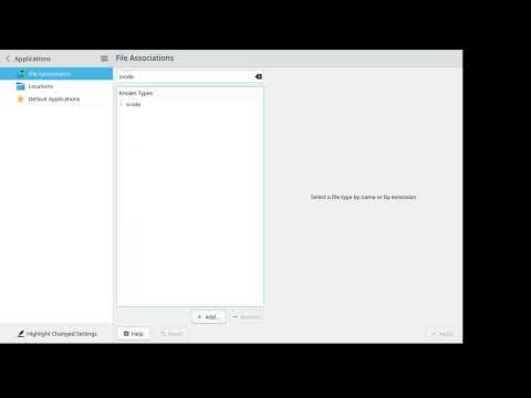

                Now, has anyone actually looked at using System Settings to fix this error?

                  The system settings and xdg-mime show that dolphin is already the preferred app, e.g.
                  "xdg-mime query default inode/directory" yields "org.kde.dolphin.desktop", and Dolphin is at the top of the list in the system settings.
