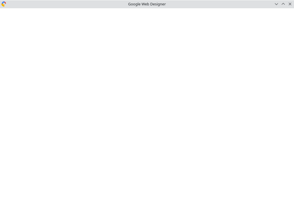

    Dear all, so far Kubuntu Jammy has been serving me great except one show-stopping problem: Google Web Designer (GWD) doesn't work. It opens to a blank white screen. The GWD log in "/home/<user>/.local/share/google-web-designer/logs/browser.log" shows:
    F0508 09:55:27 ../../shell/cef_objects/ninja_cef_client.cc:1806] Render process terminated. status=2
    F0508 09:55:28 ../../shell/cef_objects/ninja_cef_client.cc:1806] Render process terminated. status=2
    F0508 10:03:23 ../../shell/cef_objects/ninja_cef_client.cc:1806] Render process terminated. status=2
    F0508 10:07:11 ../../shell/cef_objects/ninja_cef_client.cc:1806] Render process terminated. status=2
    F0508 10:07:12 ../../shell/cef_objects/ninja_cef_client.cc:1806] Render process terminated. status=2
    F0508 10:08:58 ../../shell/cef_objects/ninja_cef_client.cc:1806] Render process terminated. status=2
    F0508 10:08:59 ../../shell/cef_objects/ninja_cef_client.cc:1806] Render process terminated. status=2
    If I run GWD from terminal it shows:
    [0509/145858.487980:FATAL:gpu_data_manager_impl_private. cc(407)] GPU process isn't usable. Goodbye.
    Trace/breakpoint trap
    Mine is not some esoteric or shine new GPU, it's IHD Graphics 2500 (Ivy Bridge i5 3330 Proc),
    and here's how the GWD looks after launch till eternity:
    Click image for larger version  Name:	Screenshot_20220509_144840.png Views:	0 Size:	12.1 KB ID:	662822

        Thanks for the prompt reply. I did all that you suggested. The problem persists. There's one catch though: I installed GWD in Ubuntu and it worked as desired. Seems the issue is specific to Kubuntu or KDE Plasma, I might be wrong though. I'm used to Kubuntu/KDE and don't find myself at home with Ubuntu.

                              Surprising, as I mentioned earlier, GWD works well on Ubuntu 22.04, but not on Kubuntu. It's puzzling.
