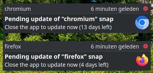

                  What I don't like is that I do get a warning a snap update is pending including the advise to shut down the application but there never is a notification the update is done.
                  For those not using Snap, this is what the notification to update looks like:
                    Click image for larger version  Name:	Screenshot_Snap.jpg Views:	5 Size:	51.8 KB ID:	674285
                    Apparently snapd 2.59.2 introduced a notification that informs the user that the updated snap is ready to be used. This should be in the soon to be released 23.10.
                    https://snapcraft.io/docs/refresh-awareness
                    Also it says they introduced a feature to 2.59 that makes apps with a "pending update" notification automatically update when they're closed, so that's good to know.
                    https://github.com/snapcore/snapd/releases/tag/2.59.1
