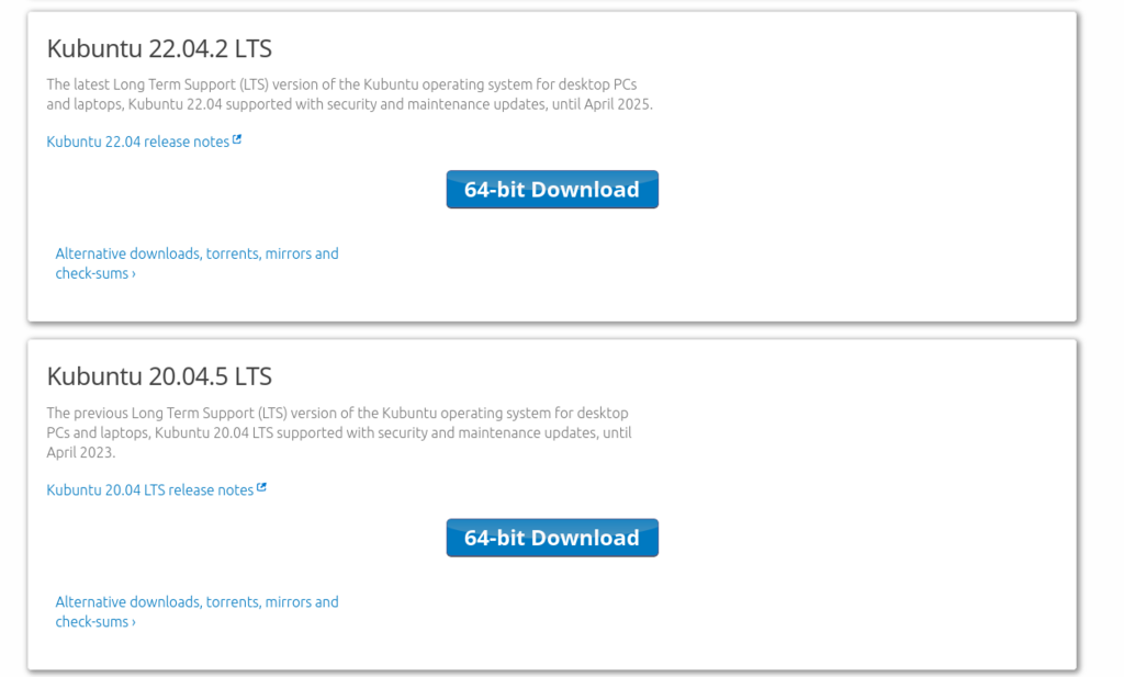

      Still, if I check https://kubuntu.org/getkubuntu/ I see that 22.04.05 is supported until april 2023. Me thinks they refer to the OS and not the plasma desktop? What do you know I still do not? And if so, why don't they make the difference clear?
        It is sort of a loophole, since Ubuntu LTS have a 5-year security support span.
        The "Flavours" only offer three.
        But since the Flavours only provide the Desktop GUI bits on top of Ubuntu, the actual OS underneath (Ubuntu 20.04) has support for 5.
        I just point this out so that you do not need to be in a rush to upgrade or do a fresh install right away, if that is a concern.
        Kubuntu will archive the iso image, and stop any work on 20.04 that they might be doing still. But the packages are still in Ubuntu's software repositories, and won't be removed or anything.
        It just will be no longer supported - no more security patches to KDE or Plasma-related stuff.
