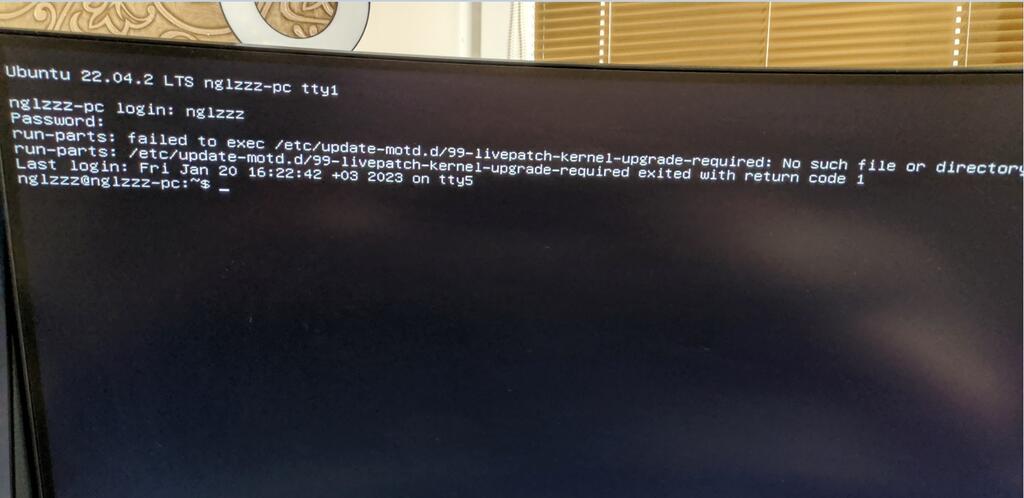

          Yes, I'm on tty right now and can see that the system suggest to run command autoremove with a lot of software (i assume more than 1k)

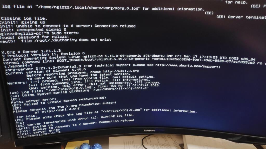

            When i try run startx i see an error:
            /etc/X11/xinit/xserverrc: 3: exec: /usr/bin/X: not found
            xinit: giving up xinit: unable to connect to X server: connection refused
            xinit: server error

              I tried to reinstall gui by command:
              sudo apt install --reinstall kde-plasma-desktop
              and still can't load to the interface:

                      you should try the correct method to start Plasma -- startplasma-x11 or startplasma-wayland
                      But I dunno why it broke for you. Unfortunately, there are too many variables to know, from the outside.
                      Originally posted by rikitiki View Post
                      I did not do any customizations in the system,
                      *before* the upgrade. Livepatch, for example? WineHQ, etc.
                      Actually, you should be booting to a 5.19 kernel after the upgrade, not the 5.15, I *think* Have you tried other kernels in grub, if you have any?
                      You had zero errors or messages during the upgrade?
