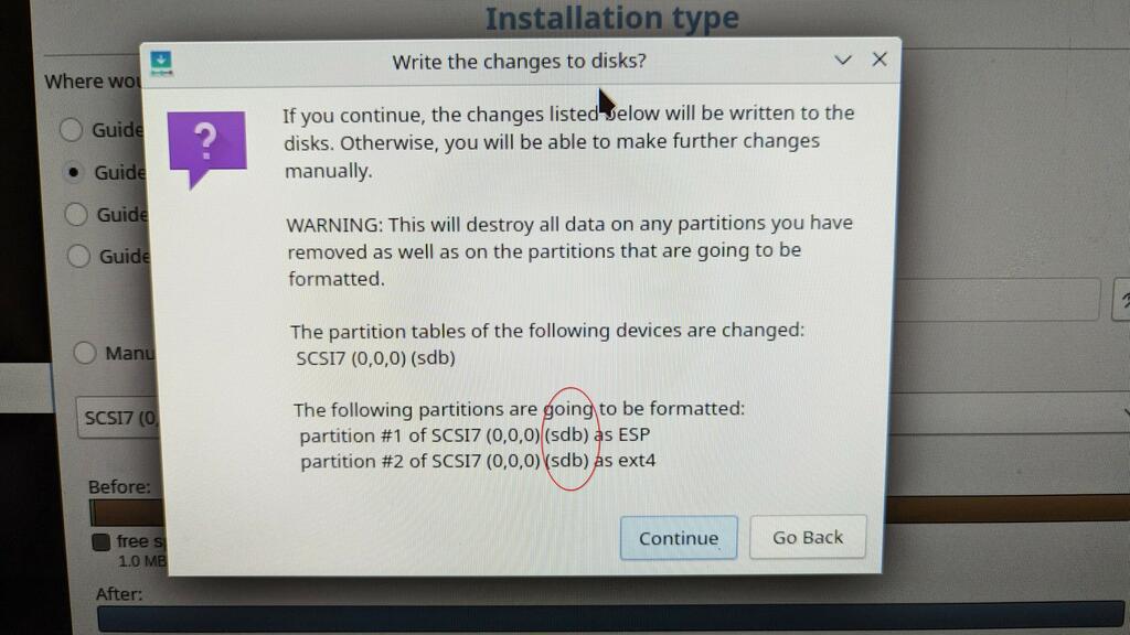

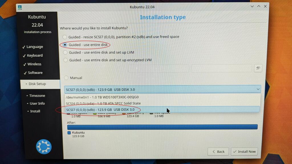

                  Just doing a basic OS install, no manual anything:
ID:	669836 Click image for larger version
                  As long as the drive names match, as shown, you should be all set to go. No manual partitioning needed.
