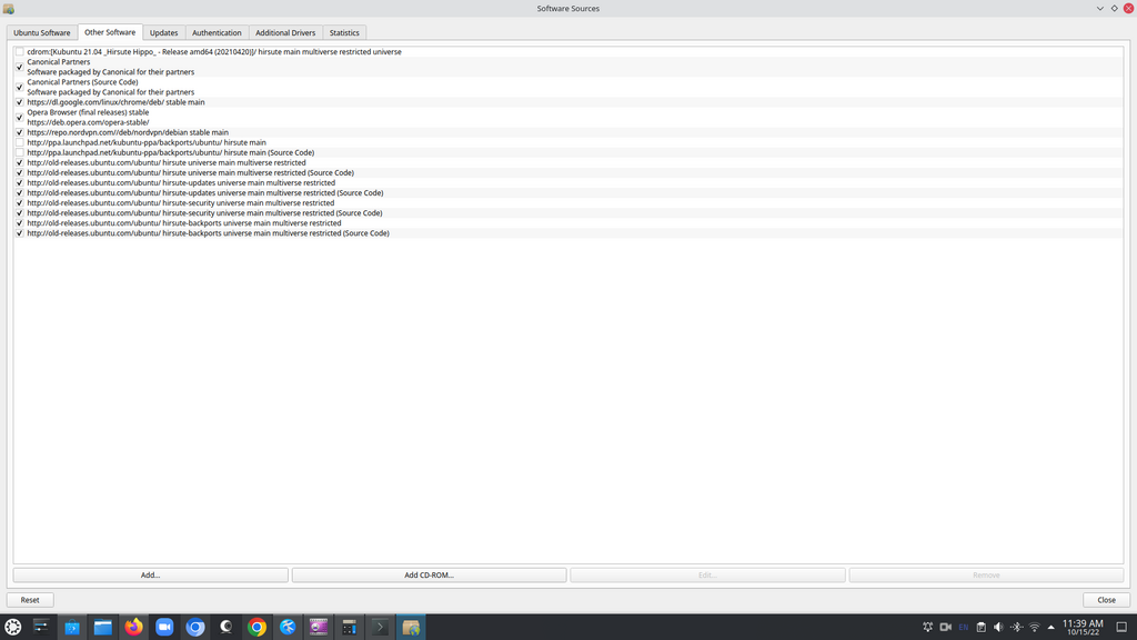

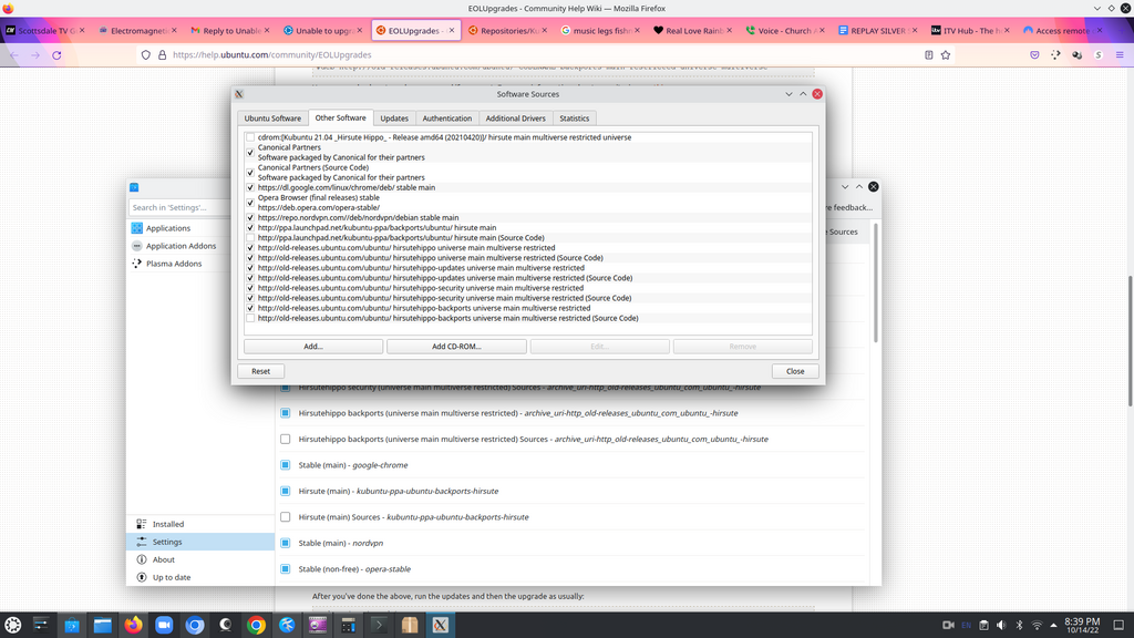

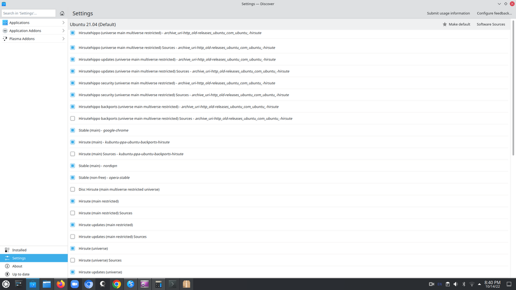

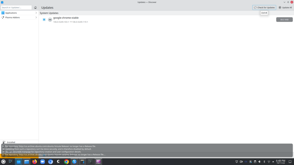

      Status Update: I have updated the software sources as noted in the article link above. Howver, I have a question about the syntax of the text I entered and an error I encountered upon refresh of the cache. THis tells me something is wrong and I suspect it has to do with the CODENAME I entered... If you go to the top on couldnotrefreshcache.png on the box on the right there is a reference to hirsute and not hirsutehippo as I have noted. Is this my problem? I have included pngs of software sources so you are able to see my entries. I believe these need to be edited, but I am not sure.
        My system is 21.04
          it should just be 'hirsute', just as it was before.
          The only change in the url is editing <country-code>.archive.ubuntu.com to old-releases.ubuntu.com. Everything else is identical.

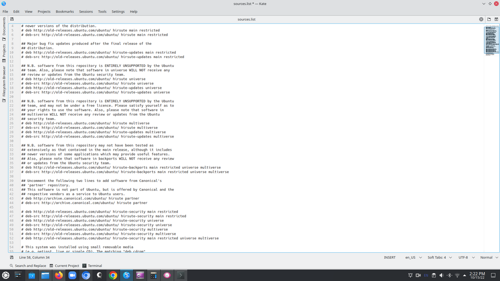

          It is much clearer and easier editing /etc/apt/sources.list with Kate or Kwrite. It will be obvious if anything was missed.
          You ignore PPAs and other external repos, those will be disabled for the upgrade process anyway.

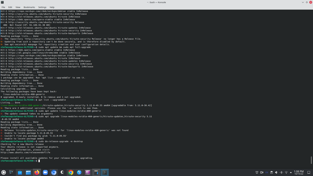

                Under 'Run the Upgrade' I got some errors. UPloading png's for DEETS...
                Do I continue the upgrade? I don't feel adventurous. I do have a copy of this drive as BU

                  Your changes made in the Software Sources may not be saving until you close the GUI tool, they are not being reflected in your terminal output.
                  Open the file /etc/apt/sources.list in Kate or Kwrite.
                  Edit all instances of us.archive to old-releases, and save. You will be prompted for your password.

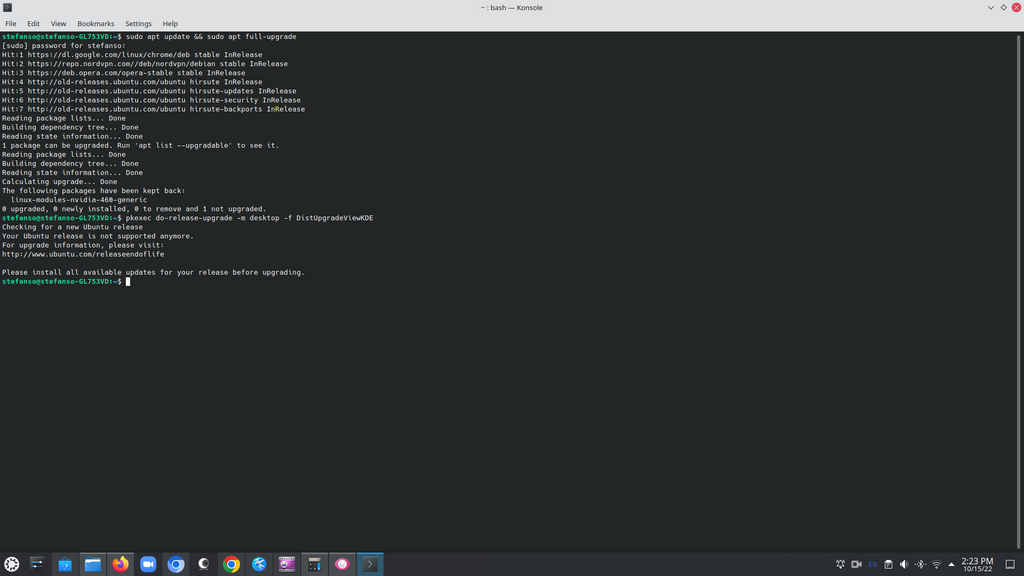

                  Hit alt-space to open krunner, and paste the command to manually start the upgrade tool:
                  pkexec do-release-upgrade -m desktop -f DistUpgradeViewKDE

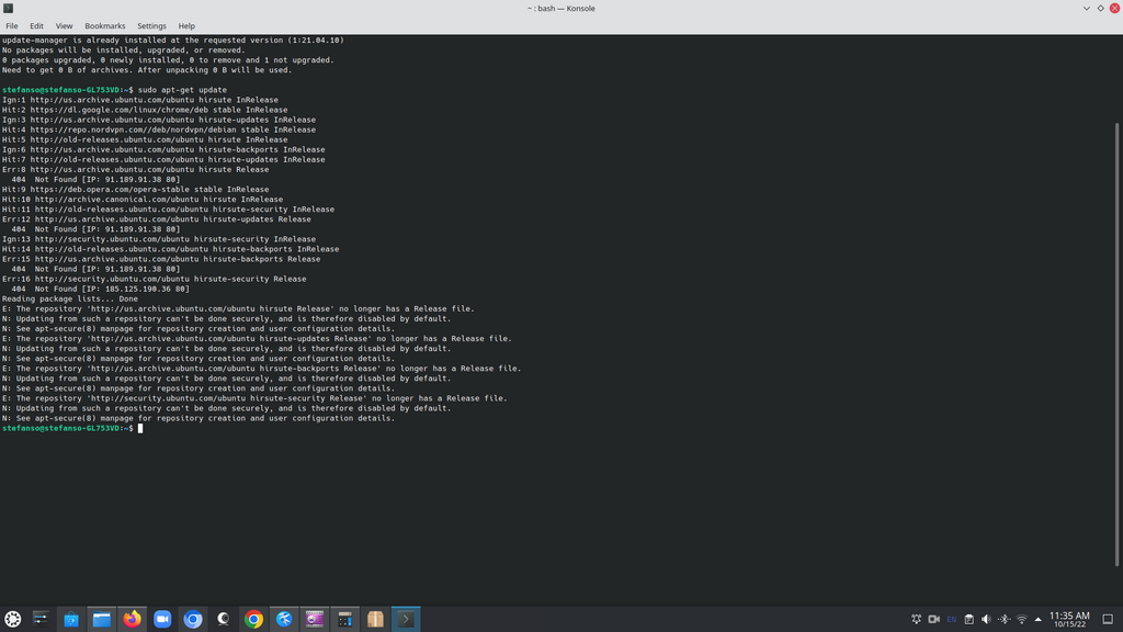

                    Well I did what you posted in the above. See the attached for screenshot. IDK?
                      Please copy and paste text, it is easier for us to copy relevant text ourselves than trying to read an image (on a borrowed 13 inch laptop in my case at the moment, was on my phone earlier lol)
                      Edit the sources.list file with the offending url with the 404 error - security.Ubuntu.com to also be old-releases.ubuntu.com
                      You need a line that has:
                      deb http://old-releases.ubuntu.com/ubuntu/ hirsute-security main restricted universe multiverse to get that last pesky package
