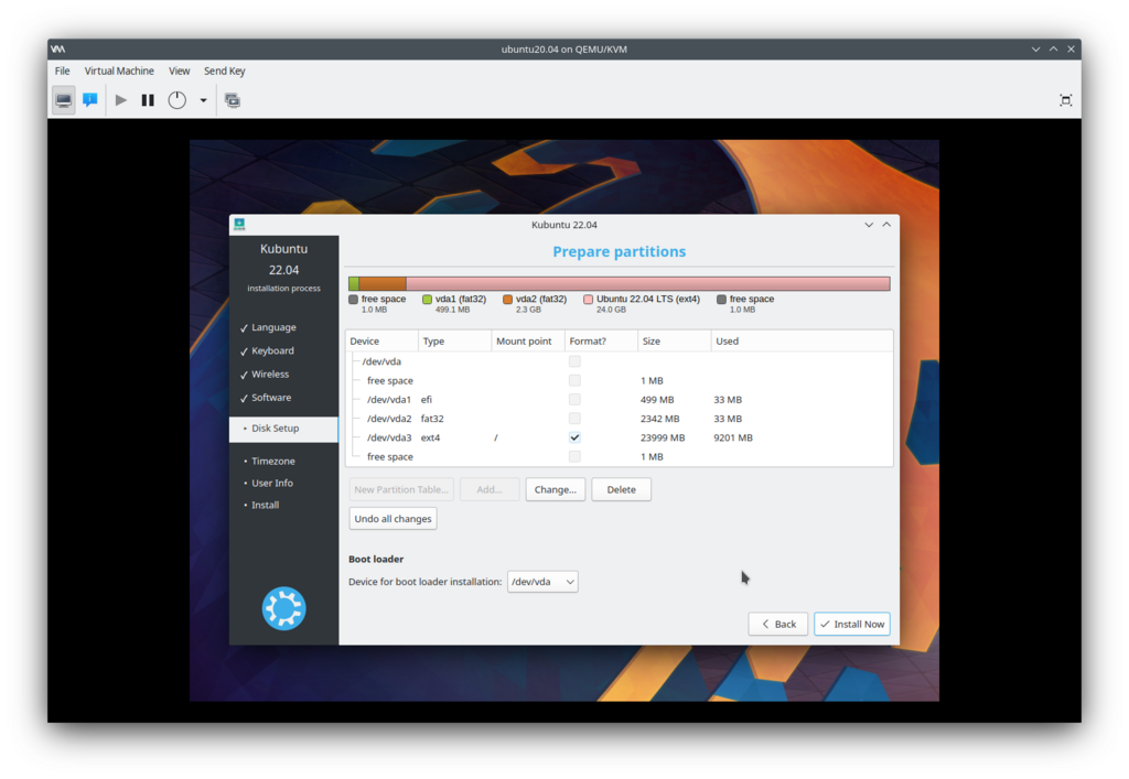

However, the Istallation type section in the installation USB only give me these four options + a manual one:
* Guided - resize /dev/nvme0n1p3 and use freed space
* Guided - use entire disk
* Guided - use entire disk and set up LVM
* Guided - use entire disk and set up encrypted LVM
* Manual
If I choose the first option, I see that the 3rd partition is divided equally between Ubuntu and Kubuntu. I see I can move the division line do reduce the Ubuntu size, but not to zero.
The second option seems to eliminate the other two partitions, so it doesn't look right.

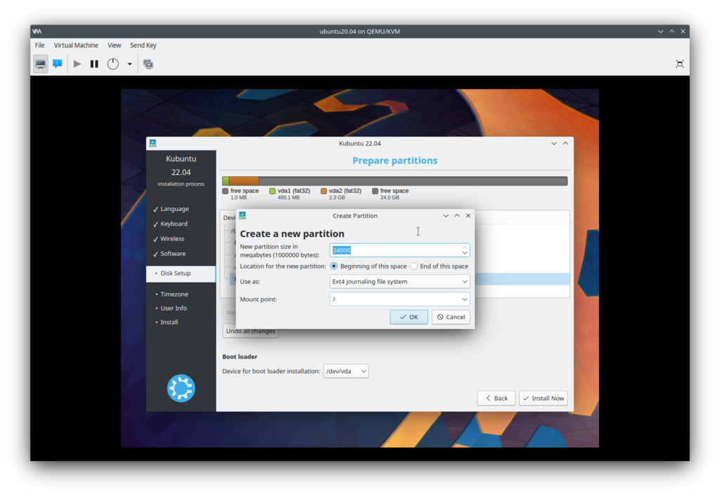

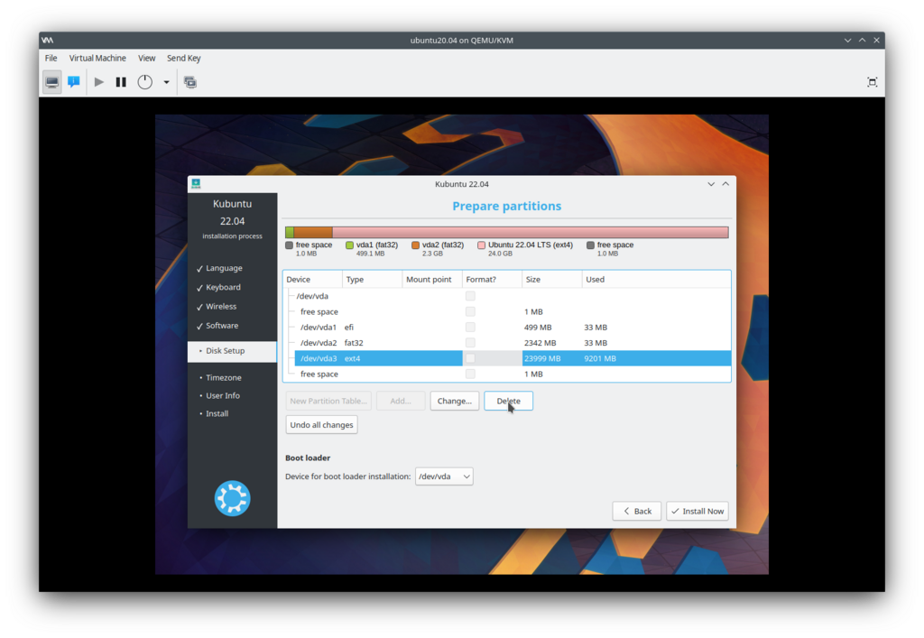

The "manual" option leads me to a screen where I can add, change, delete partitions. I find it a little scary because I'm very ignorant about partitions, filesystems, mount points, and such. I have read the DiskSpace pages at helpubuntu, but I am not sure I understand it fully.
So how can I install Kubuntu 22.04 in place of Ubuntu 22.04?
