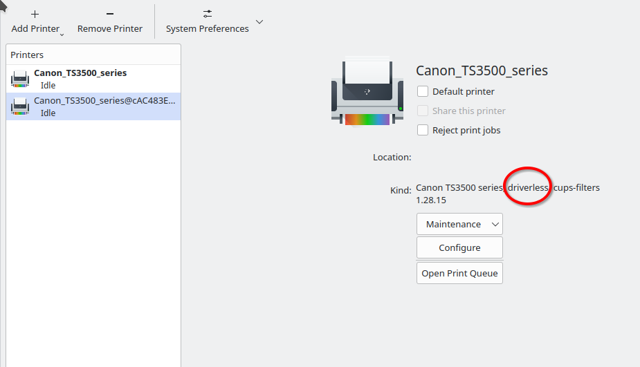

      First, does the printer show up in System Settings? HPLIP-GUI is not at all necessary for actual printing, most of the time.
      If it does, and it mentions "driverless" in the summary similar to this:
      Try uninstalling the package ipp-usb.
      This may be a long shot, as this used to be a problem in 20.04, and maybe earlier.
      This package allows USB connected printers to use the 'driverless' mode used by wifi printing, which is a sort of standard thing a LOT of printers support. No drivers to download or install or find.
      Removing this package, then removing and re-plugging the printer may allow HPLIP to be able to communicate with the printer in the old fashioned way.
      Or just go wireless

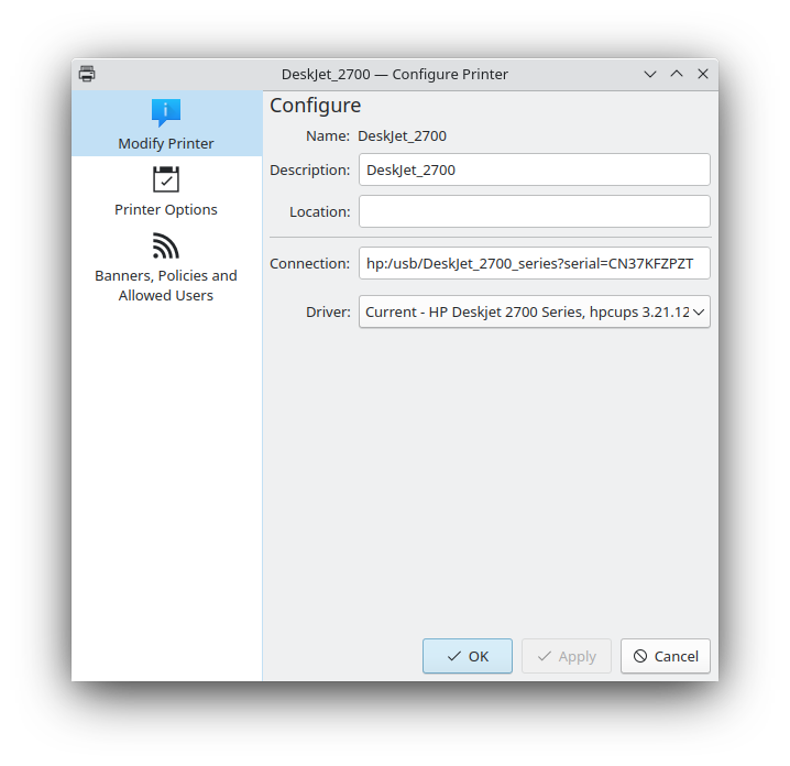

          And see the 2 screen shots -- the printer is seen.
            There was no mention of "driverless" in my output, System Settings.

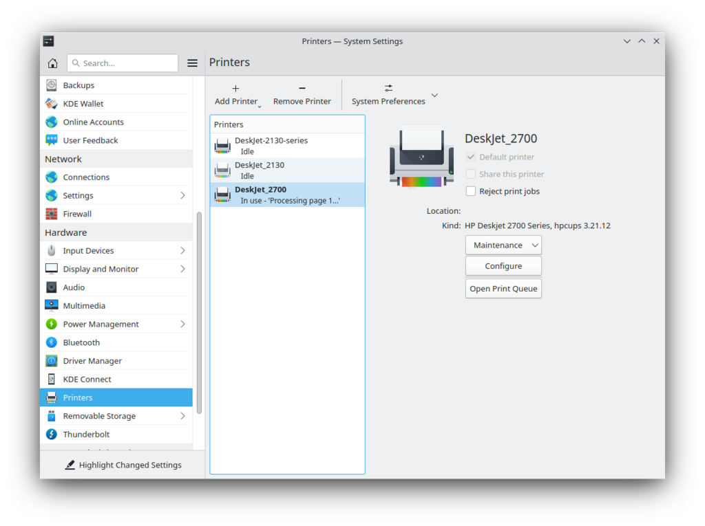

            Are you attempting to use the full HPLIP GUI suite?
            Yes, I think so. I open HP Device Manager to see the printer, or to select "Scan" under Actions, and so on.
            Here's how HP Device Manager sees it, note that there is nothing under "Actions"!
            -- see screen shot --
              Should I still try that?
              No, it's not using a driverless setup.

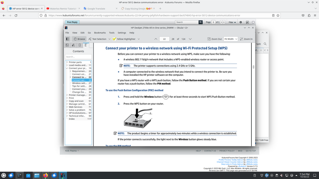

                  Connect to a wireless network with a router
                  TIP: To print the Wireless Quick Start Guide, press and hold the Information button (i ) for 3 seconds.​
                  I found a manual: http://www1.hp.com/ctg/Manual/c07043348.pdf page 22

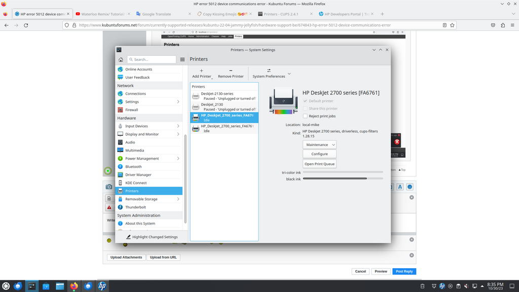

                          A quick post for now, it's late and I'm pooped:
                          -- I got the printer attached by wireless using WPS. See manual page below.
                          -- It prints.
                          -- I can see and manage it in CUPS, localhost:631, and print test page etc.
                          -- I can see and use Kubuntu with it: K > Settings > System Settings > Printers --> see attached screen shot
                          -- hplip will not include it in its list of printers: "hplip can not detect the device"
                          -- xsane will not scan with it: "no documents in the document feeder" (I have no document feeder!) BUT, xsane gives me the preview perfectly!
                          So I have to work on the scanning, where I place the document to be scanned face-down on the printer window and use xsane to get a scan of it.
                          So far, there is no USB-connected capability.
                          I did get the "driverless" description, btw.

                              SANE, the Linux scanner support system sees and present both, or Xsane sees both. Not unusual at all.
                              I usually use KDE's Skanlite (may already be installed on your system by default) and Skanpage (this one is only available in 22.04 via snap/flatpak). Both of these only show 1 device for me, while Xsane reports 2 - an airscan and an escl device, which is redundant. Probably just a feature or quirk in the software.
                              I have always seen two devices with Xsane since I started scanning over wifi. The other applications have not.
                              In your case, using both Airscan and hpaio, it might be advertising itself as two devices, as far as SANE is concerned.
