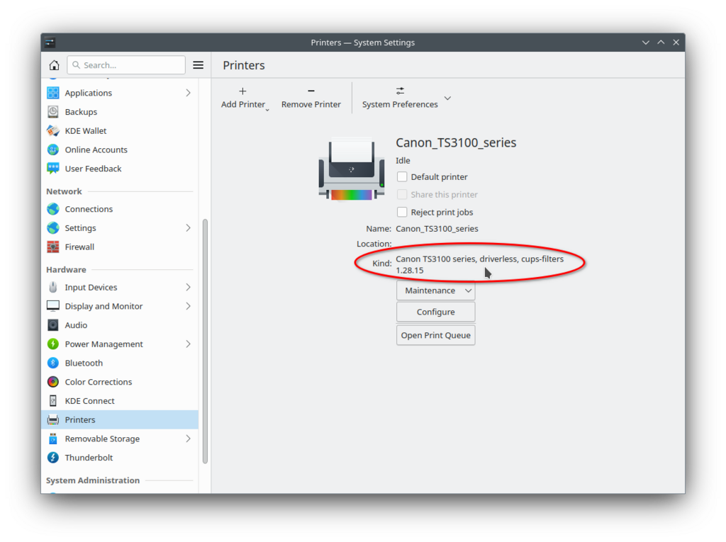

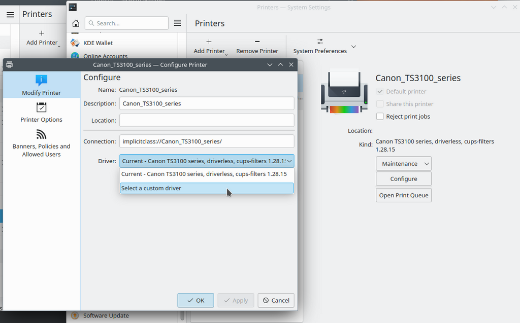

    You should be able to see the driver version directly from System Settings' printer section:
    Click image for larger version  Name:	Screenshot_20230122_130537.png Views:	0 Size:	153.0 KB ID:	667948

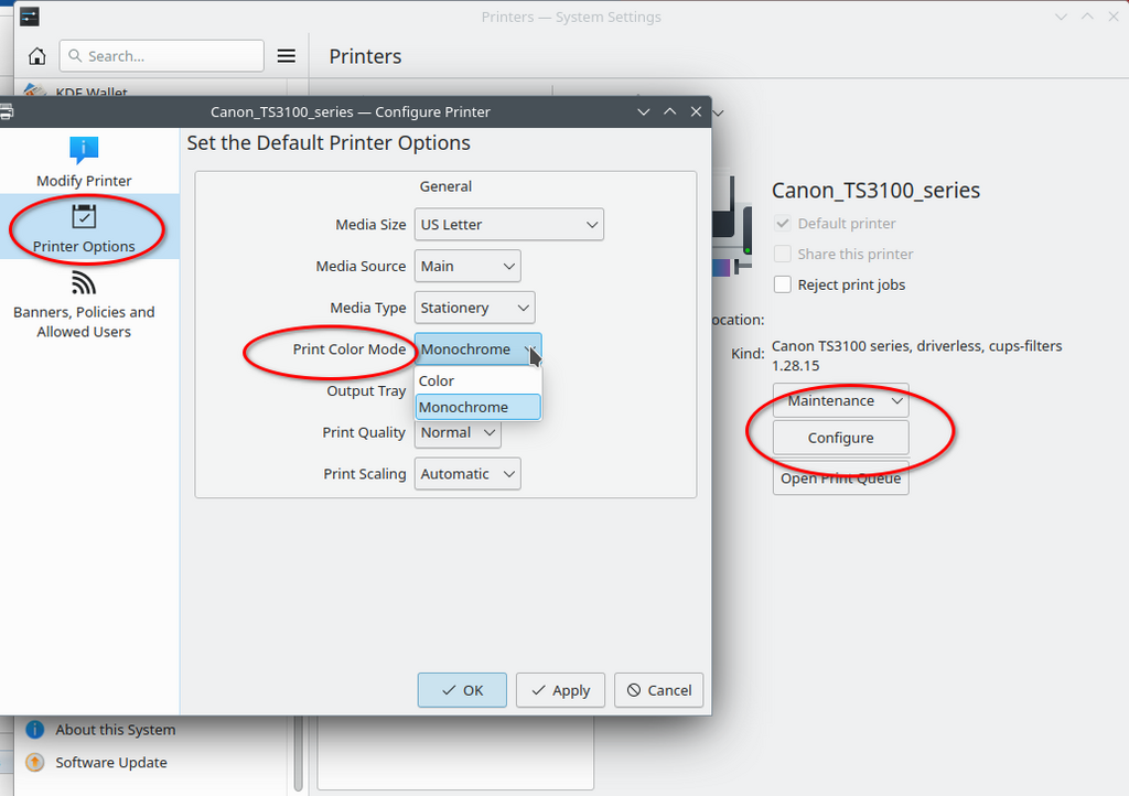

    You can also see this from the 'configure' options' , where you can also see and choose different drivers, of any, for your printer model.:

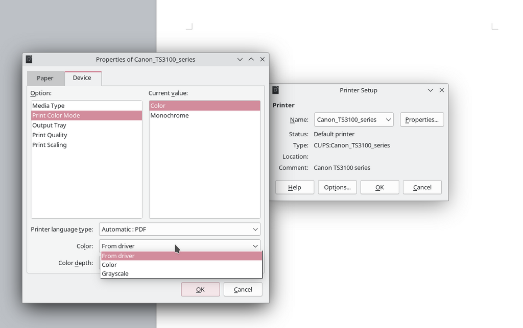

    You might also need to check both the Libreoffice's print settings as well as the printer config in System Settings, just to double check that neither is set to 'monochrome' or 'greyscale' or something.

        The first answer is just going a little further than what my original screenshots show, and making sure the driver isn't by default set to monochrome:

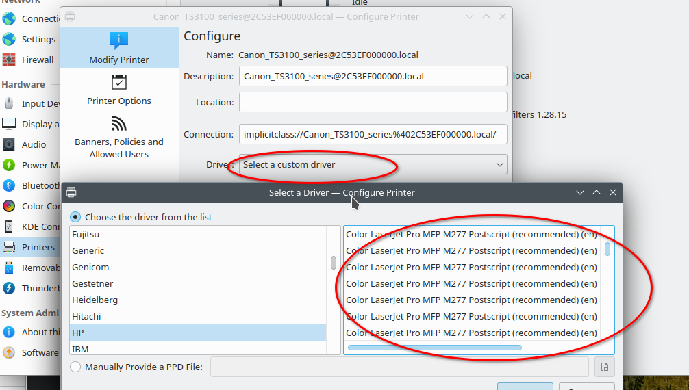

        The third response is to manually search for and choose a different driver variant for your printer, if you have one available.
        You may want to use the exact name shown in your dialogs, I am just guessing here, but it shows a number of different ones to try out, though they all are labelled identically:

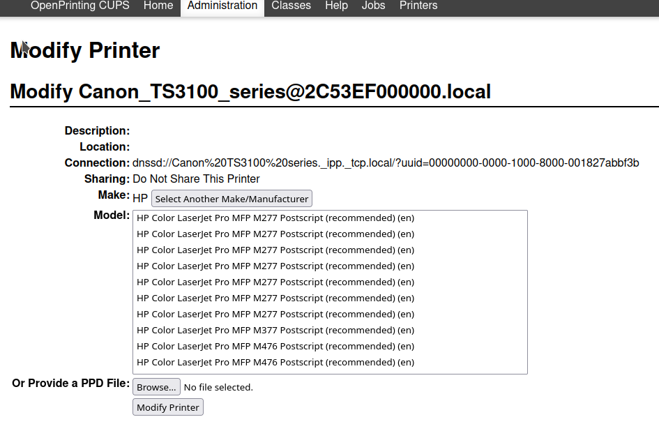

        On a side note, for the third response, and my second pic above, you may see that the listings for the different drivers is not very descriptive

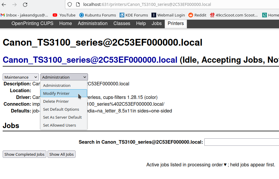

        An alternative GUI that may show better info is the web interface, similar to mentioned above.
        go to https://localhost:631 and look around there, and you can configure the printer from there

        However, I didn't see any better descriptions for the same drivers I was looking at - assuming that theses are correct for your printer
        This may not be a useful option here for you.

                  But it is odd that the OP's printer isn't showing the driver used - though I suspect the name of the printer IS the ppd being loaded here, but can't confirm without a screenshot or something from them.
                  Similar to that other printer thread here, for example
                  Also note on my screenshot above here, the driver IS shown as the 'driverless' one.
                  The OP still hasn't mentioned if they have checked the print settings , as I show in pic#1 in post #4, or if any of the other 'duplicate' ppd entries have been tried, to see if they act differently. I don't blame anyone for not trying that one, though. '

                            • Have the print settings in BOTH LibreOffice's print settings AND the printer settings been double checked that they are not set to monochrome or greyscale? LO has its own configurations for this

                              Well folks, I have some good news. The pictures with the red borders now print RED!!! The problem was in Writer. I first got the printer to print a test page without being connected to the computer. The test page showed vivid colors. Then I connected the computer to the printer, and I printed another test page. It too looked super (bright colors). Then I printed a page with Writer. That page has a picture with a border. The border printed gray. I knew then the problem was in Writer. I again hit "Print", and this time I clicked on "Properties". The next screen shows "Paper" and "Device". I clicked on "Device", and the first item in the list says, "Print Color as Gray". It was turned "ON"; so I switched it to "Off", and the problem was solved.
