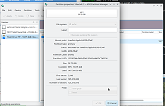

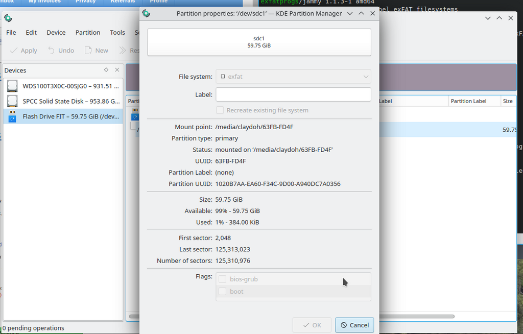

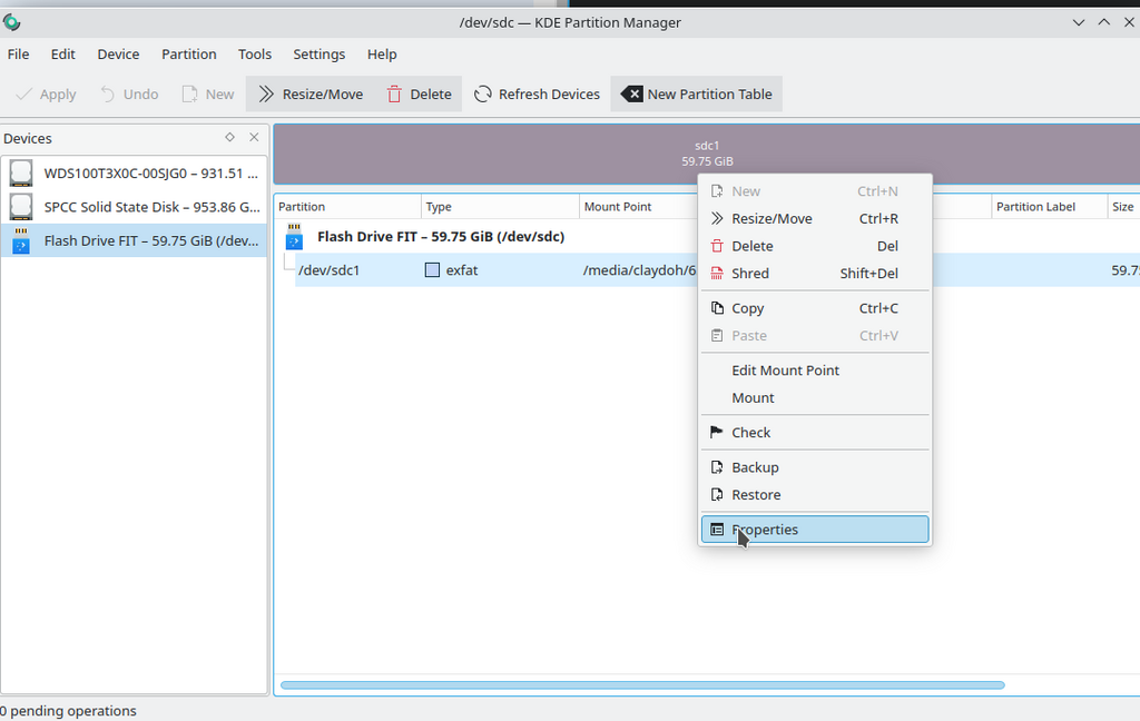

ID:	665805 Click image for larger version
      What make/model/size is the USB SSD? What is it formatted as?
      Open Konsole. Plug the USB SSD in and when the 'little blue light' goes on, run: sudo dmesg
      Copy the last 20 lines and paste here in your reply.
