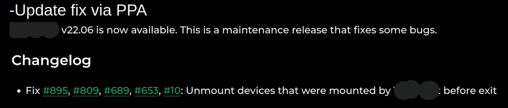

      Timeshift did it. Update: I probably did it. I downloaded from one from PPA, claiming it had fix for the bug. All it did was remove the part where a password was required to unmount. The hook is still in there. A USB ext4 has to be plugged in for it to boot and shut down. I would not mind this requirement so much, but when you uninstall the program, it leaves the binding in, and you need a USB ext4 plugged in 4ever after being raped by Timeshift. It is like having to ask someone for your own car keys every time you want to drive your car. Let me know if you need any more info.

                I found a TeeJee PPA that had his latest version which claimed it would fix the mount problem, It did not, all it would do is allow to unmount without a password in Dolphin, (the boot/shutdown problem remained) but the ext4 USB still had to be in the USB port for shutdown/boot. Then the next time I tried to unmount in Dolphin, it asked for a password, Fickle thing.
