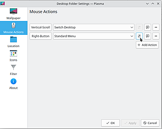

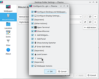

    You should have a "leave" option on the right click menus.
    If not, you can add it, among other options to tweak.
    Right-click on Desktop >>> Configure Desktop >> Mouse actions > click the config button

      Good morning claydoh,
      Thank you for your reply. The fix was easily applied thanks to your very clear instructions and is working just fine.

        That "leave" option (on rt-clicking the Desktop) is already there (i.e., check-marked already) on my recently installed 22.04.
