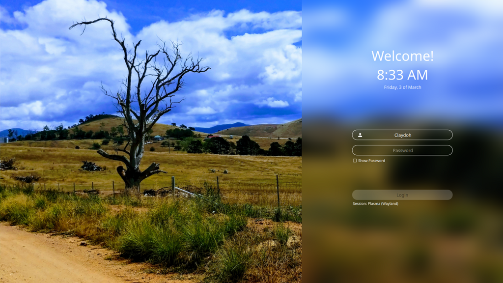

            Still tweaking this one, slowly. I hardly ever see it.

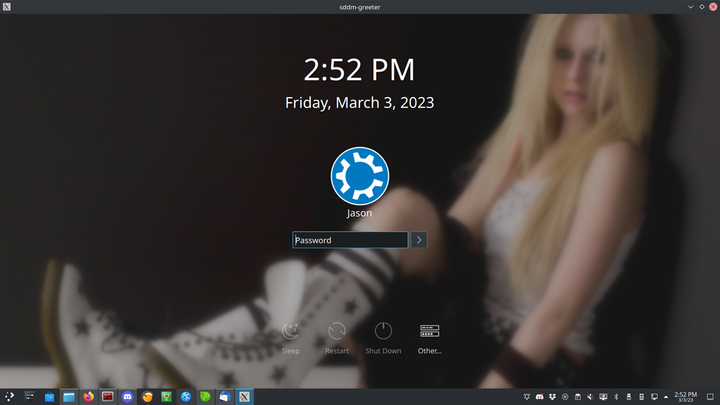

                  I managed to get the screenshot take before it blurred the entire background out. I do wish I knew how to stop that behavior.
                    Ahem....
                      That looks doable. I'll have to do a little research to find what to edit for the login screen.
                        You probably will need to swap the sddm theme. I am sure the qml in the theme files can be edited for this, but no idea how, even after looking. Other themes are available without blur, so have already done the hard work
