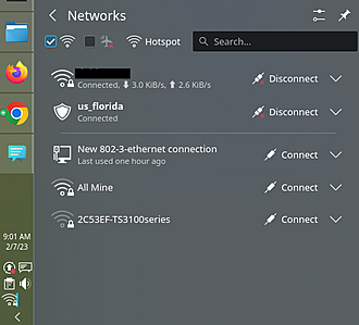

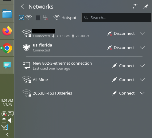

    Not as far as I can tell, unless maybe you have manually created or imported a VPN connection using OpenVPN or Wireguaurd or similar and have connect to that. I haven't done that in ages, and can't recall if the icon is different there or not.. There IS a separate icon for it, but that is for the actual VPN connection, not for your physical connection.
    Ok, so yes, it will add a lock icon, if you have separate VPN connections via Network Manager. This won't happen using many third party applications supplied by VPN providers.

              Manually creating an OpenVPN connection (importing an ovpn file and modifying some settings), then connecting to this as well as my WiFi/Ethernet, the lock icon appears, as seen in my image. Those are the stock Breeze icons.

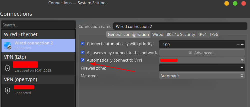

                i use OpenVPN connection imported from .ovpn file. I connect to it manually or automatically with option "auto connect" from wired connection setting.
