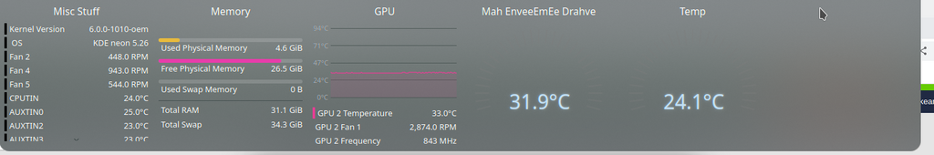

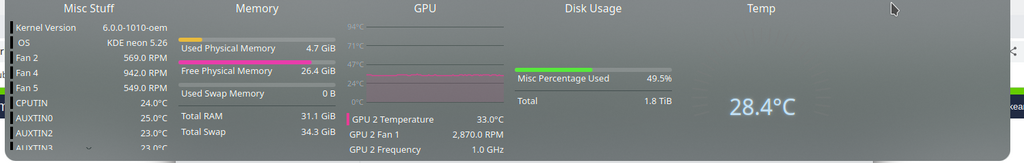

              Have you looked at creating your own widget (sort of) by using System Monitor Sensor widget(s), and customizing it to show what you want?
              With third party widgets, you are at the mercy of whoever slapped it together bothering to update things as needed, when probably all they did was to hack together something and toss it out there.
              The widget is both easy and difficult.
              I used these to create an experiment for an unfinished dropdown nerd stats panel when I was using Latte Dock, so my example may be odd, as it is a very tall panel -240 - but you can see I quickly edited some existing widgets to show just a title and temp, which should scale to a normal panel, I think.
              let's see:
              These are using a gradient Gauge, or just the Digital Gauge Display Style which my plasma style is obscuring some theming elements, probably not good when shrunk down to a normal panel height
              Lets shrink it down, install and modify the Colorful Sensor display style from within the widget
              And more tweakage
              Might work? It does allow, or rather requires, that one select specific hardware sensors (via lmsensors), which can be very useful for this purpose when standalone widgets don't look for the correct ones.

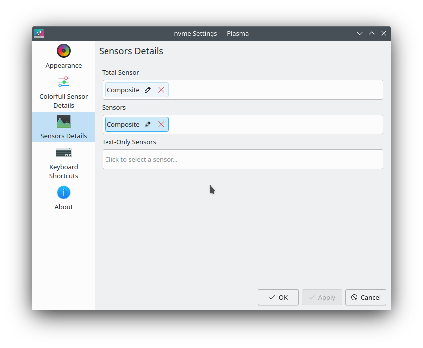

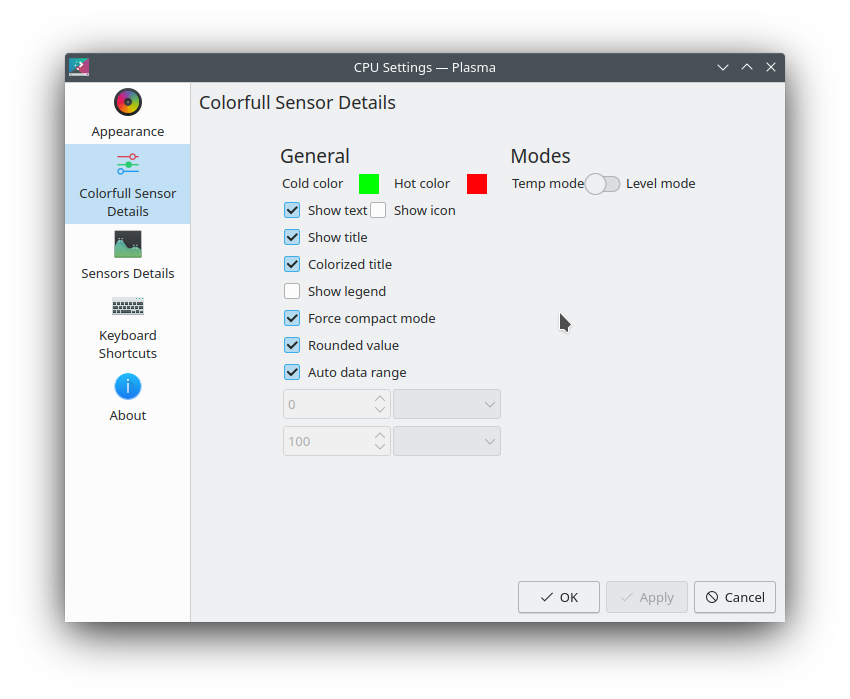

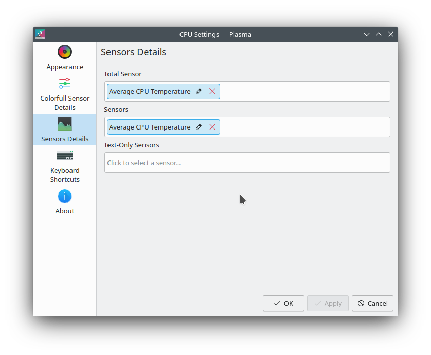

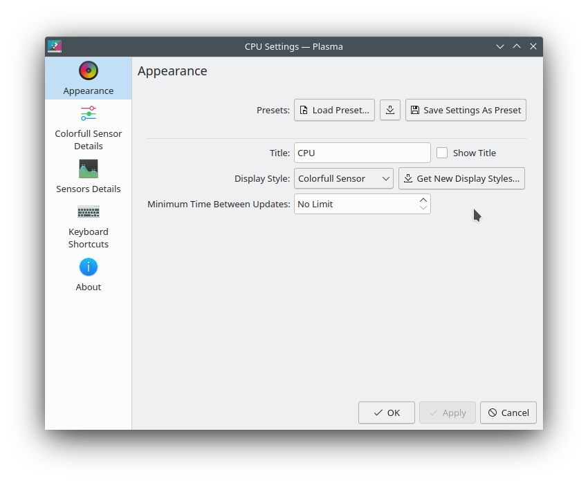

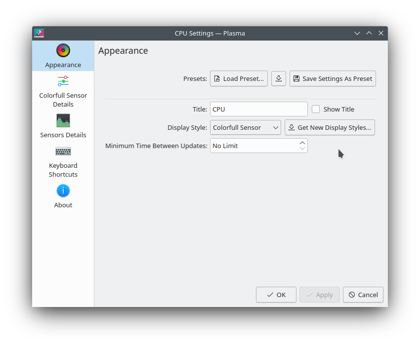

                  I had to install the 'Colorfull Sensor' display style, and experiment with colors and settings. The plasma style used has an effect on the text color, which can make elements disappear.
                  The 'text-only' is not quite what you want, it shows exactly like the bottom half of my GPU sensor in the tall examples.
                  here are how I have the CPU set up as shown
ID:	667681 Click image for larger version
ID:	667682 Click image for larger version

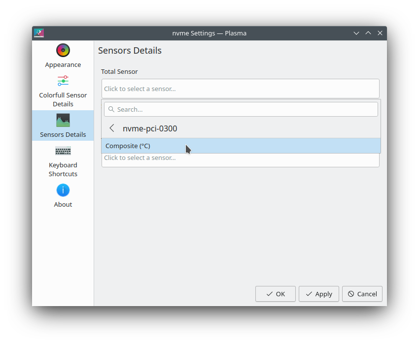

                    And the NVME:
ID:	667686 Click image for larger version
