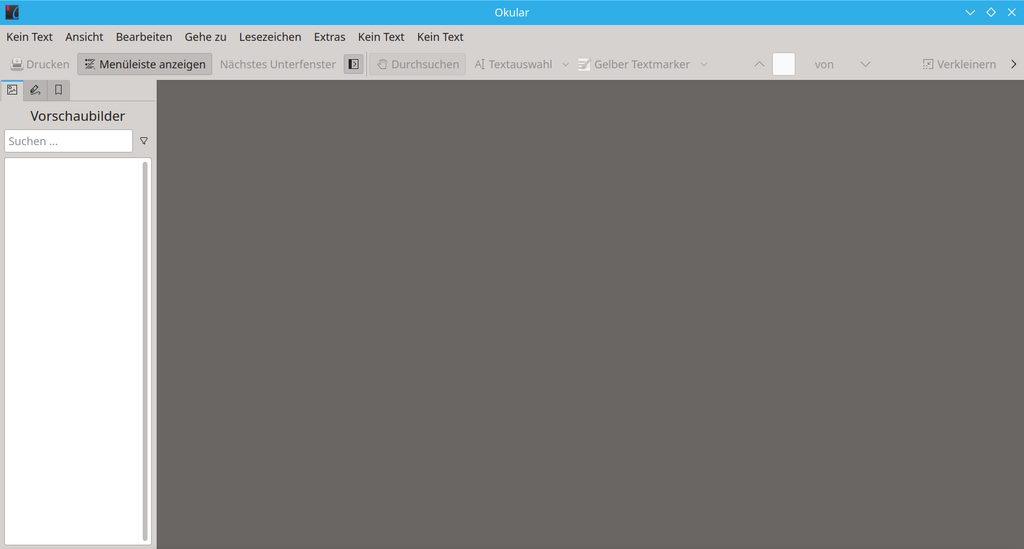

      No, I am NOT simply missing the top row menu items. They ARE displayed as follows (in German, with most of the submenu items greyed out. See screenshot below
      Screenshot of Okular with corrupt Menubar):
      Kein Text (=No Text, should be File) Ansicht (=View) Bearbeiten (=Edit) Gehe zu (=Go to) Lesezeichen (=Bookmarks) Extras Kein Text Kein Text

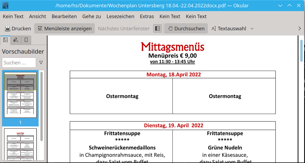

            It helped - kind of! Okular functions correctly with regard to its intended functionality. However, as far as the menus are concerned...
            - submenus are displayed correctly (not shown on the screenshot!) while they were greyed out before;
            - top-level items still show the same behavior ("no text").
            By the way -- the luncheon menu shown was very tasty! Here comes a screenshot:
            Menu items after PPA
