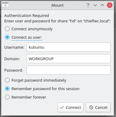

                  EDIT: I don't know if it's related to the issue but the popup window is different for both file managers when they ask for my login/pass for the shared folder.
